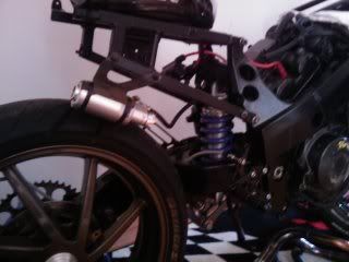

Dude, I'm jelous
Pop round I have a pre modified rear subframe for you rather than hacking at yours !
old mobile phone pic but you get the idea, recognise the wheel
