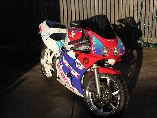

My first nc30, nothing special but it was in better than average condition. Sold it to get a race bike, I covered about 40,000km's in 2 years on it:

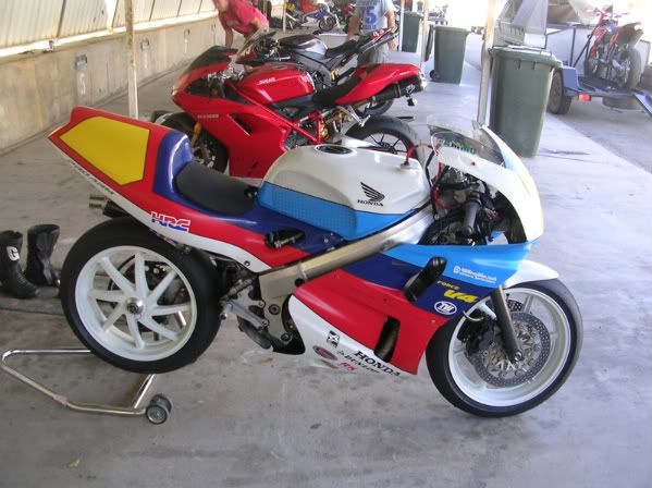

The race bike that I bought. Doesn't look special, but the spec was good. It had good parts, I tuned the carbs and changed lots of other bits and pieces:

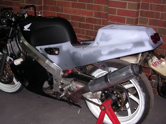

Quick tidy up and paint job:
This is how it currently looks:
Spec:
- Fresh rebuilt RVF engine, quitening gears removed
- HRC full exhaust system/muffler
- NC30 carbs w/HRC scoop, HRC needles, HRC velocity stacks, HRC emulsion tubes, NC24 slides, HRC modded bracket etc.
- NC35 HRC CDI w/race loom
- RC30 top radiator
- Racetech fork springs
- WP internals in rear shock, compression adjustment added
- Performance Friction carbon front pads
- WR's rearsets
- Sansei clipons
- CRG shorty levers
- YTX4 battery
- Lots of weight saving performed!
- G-force gixxer flywheel adapter still to be fitted
- Very fun!!

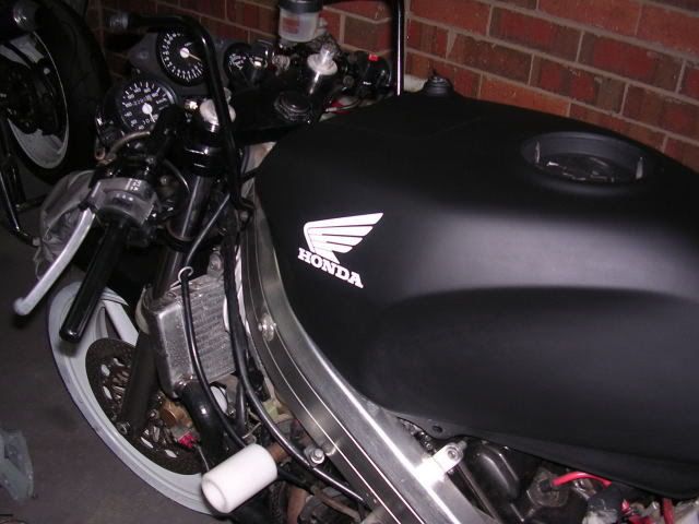

A little bit more work done recently on the road bike.
Most of the painting is done, I overhauled the forks, and I’ve taken it out to stretch its legs a couple of times with no dramas.
Unknown mild steel half system, ethos pipe, and cbr400 tail light (was all I had sitting around!):
Gotta love matt black for easy spraying!

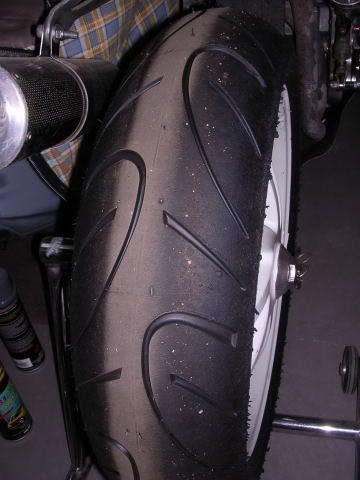

Whacked some spare track tyres on the roadie for now, good times to come!
