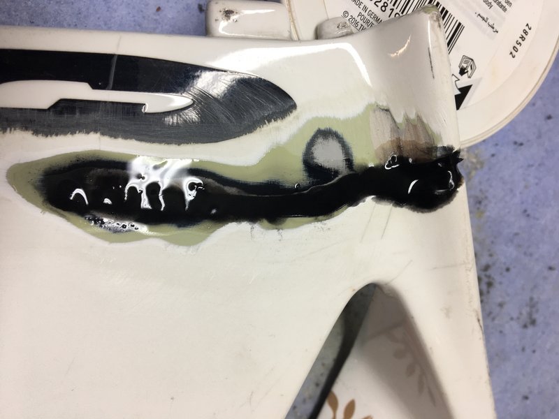

Having repaired some of the fairings for my original Rothmans bike I had come across “Plastex” before and knew from that experience that if done right the repairs using it are really good. A bit of searching on the Internet and it appears that it is either called Plastex or Plastech. Not sure if one is the US version and one European or if they are actually 2 different firms, however they are effectively the same stuff. It is basically an acrylic resin powder and an activating liquid. You also get a reusable folding bar that you can use to re-cast missing lugs etc.
You can sprinkle the powder onto the crack and then add the liquid, which is what I did to start with but this is messy and uses too much of your precious product. Actually spending some time to learn the technique of dropping a few drops of the liquid into the powder and then lifting a ball of powder/liquid onto the repair area is well worth it. it is neater, much more controlled and you can build bigger repairs up layer on layer. There are loads of videos on You Tube but if you Google “Plastech - Ultimate Motorcycle Plastic Repair Kit - How To Use” you will find the ‘Men and Motors’ review. Whilst his accent is a bit annoying at least it is not a Yeee Hawww ‘Merican.
Plastex will bond to just about anything, but obviously is much better bonding to a prepared/keyed surface. For an example I will show the repair on a ‘simple’ crack.
Voila the L/H mid fairing from my original Rothmans (more about the lower later).
Not only had this cracked, it had cracked along a previous plastic weld / hot wire repair.
So first things first sand it back to help key the surface but also so you can actually see what you are working with.
As you can see I also removed the shitty repair from the rear of the panel and rubbed that down as I would be repairing this from both sides for maximum strength. Then what you want to do is open up the crack so you have more surface area for the Plastex to bond to IE grind the crack into a “V” profile. My weapon of choice for this is a Dremmel with a conical grinding bit…
Using this (or something similar) grind along the crack like so…
Then fill the crack using either technique. I was still applying powder then liquid at this point as I hadn’t perfected the alternative method. Having done so I would recommend the “picking up balls of powder” technique ….but both work.
Now you need to have a bit of patience. The adverts will tell you maybe 20-30 minutes drying time but the longer you can leave it (particularly for larger repairs) the better. As I had a lot to repair I could do a repair and then leave it for hours, or even overnight, whilst I was working on other panels. This was great as it was then properly dry when I got back to it. When you do you can give it a bit of a rub down and see where you are at. If it doesn’t fully ‘fill’ the crack, just give it another application to build it up until it is just slightly proud. Allow it to dry properly and then just sand it back flush - job done.

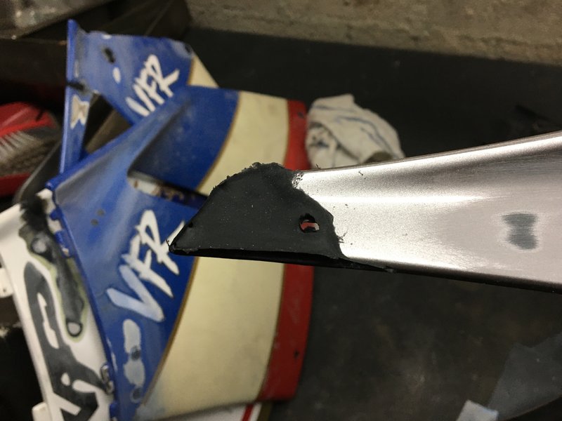

Moving onto recasting missing bits of plastic…
The nosecone that I had to work with had seen better days. It was missing a piece near the L/H mirror mount and also the central mounting hole was errrr…missing.
Using the moulding bar that comes with the kit, I took a cast of the missing elements from some of the other ‘complete’ fairings I have…
Then you key the adjoining surface a bit (done after the photo was taken) fix the mould to the fairing to be repaired and start to build up your repair. I would say patience it key here and I probably went back 3 or 4 times to build these up to a full repair.
Allow to dry and carefully remove the mould.
Once they have had chance to properly dry, sand to shape and if needs be add another drop or two of Plastex to fill in any voids or low areas, let dry and sand again.

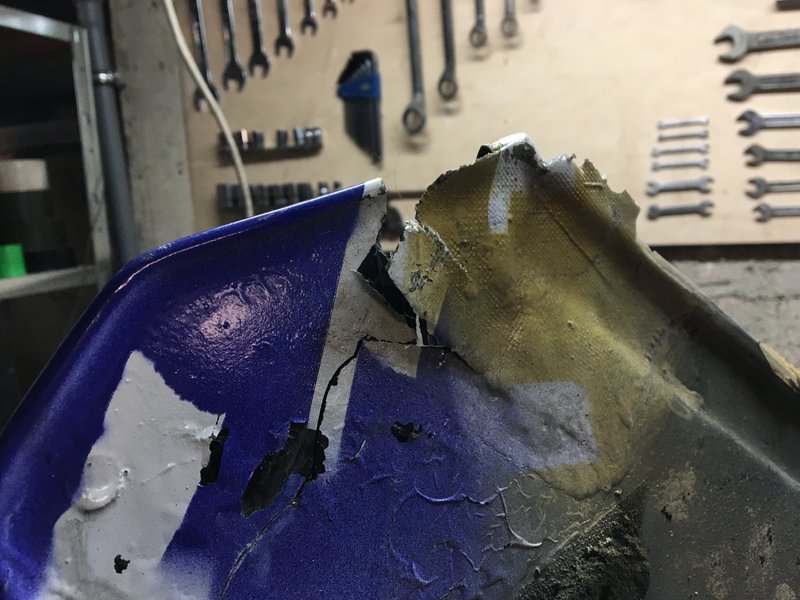

Moving onto larger areas or combined repairs…..
The side fairings that came with the third bike were actually OEM but the mids had been drilled to ty-wrap into a non OEM nosecone and the lowers had been cut, presumably for R&G style crash bungs.
To fix these I once again keyed the surrounding surface and then made trough template out of aluminium tape.
Again over several applications with time to dry in-between (more patience needed for bigger repairs) I then just built up the missing plastic area.
once it is dry, remove the tape and sand to shape (Note also addition of a re-cast lug at the top of the panel)
