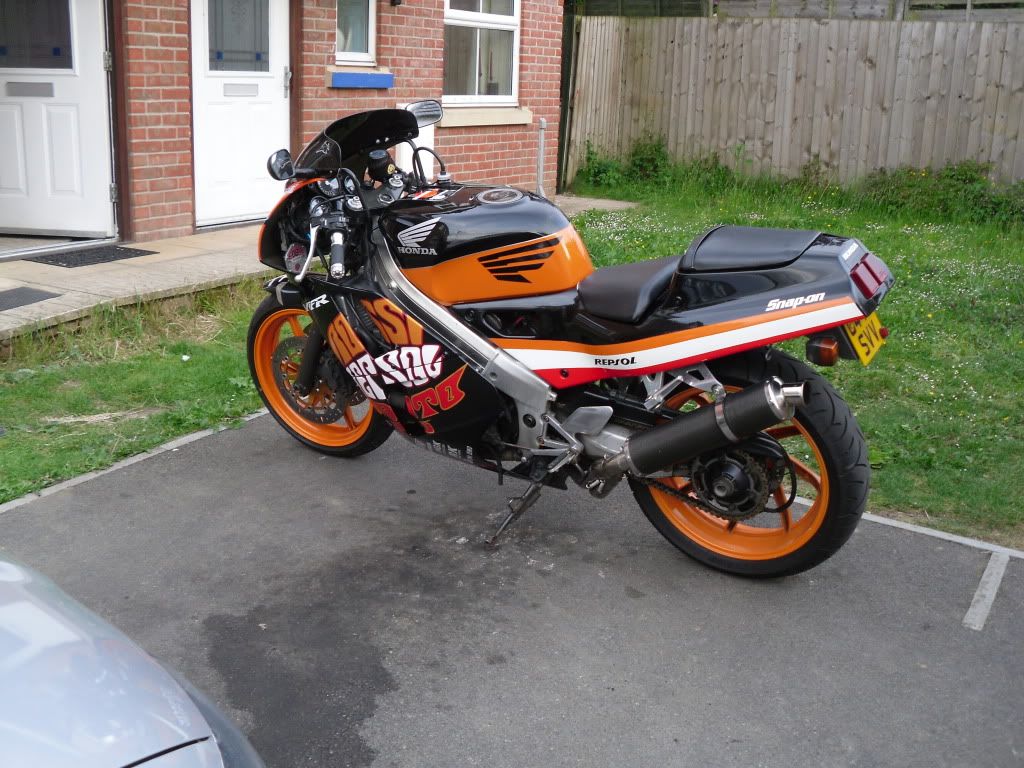

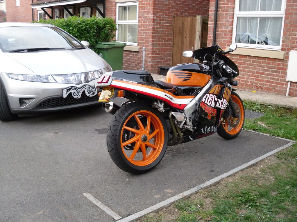

Re: Deviants nc30 strip and rebuild
yeah its my bike in the avatar , heres how she looks today,
lizardman the panels will be up for sale later on , its an aftermarket front end but fits quite well and paint is good
the seat unit is OE but the paint job is a bit crummy (i also have the OE front panels in the repsol scheme again its a bit crummy in the paint area and has some broken lugs in the usual places the reason why i bought a second set in the first place ,

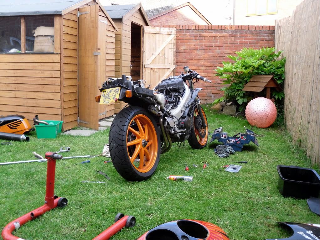

The rebuild begins , today i went for a last blat then wheeled her round to the back garden to set about the strip down ,
fairings off , radiators drained , oil draned , clocks removed, front downpipes and collector removed engine bolts loosened with the home made socket jobby, swinger lockwashers loosened and the big 46mm sprocket nut loose ready for rear caliper removal then the subframe,
tomorrow she will go up on stands for the forks out, swinger off, to the point its just the frame sat on the engine.
then the final stage of strip , carbs off etc
looking at the parts so far, radiators need binning as the bottom one was just hanging on the hoses as the bracket had corroded thru and the top bracket had come away from the radiator
most nuts/bolts will have to be replaced as it looks like most have been done/undone with the wrong size sockets and are butchered in one way or another .
its dawned on me that this will be a massive job of cleaning every nut bolt washer bracket , (looks nice when the fairings are on but under her clothes she is a slag, and a very dirty cow ,

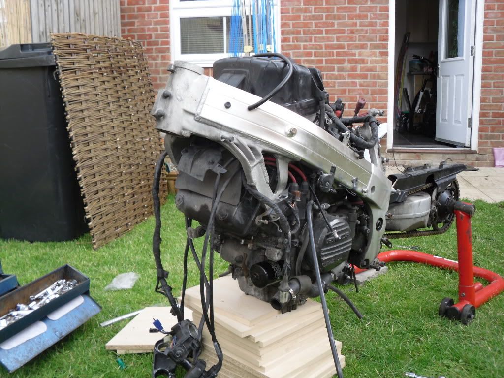

day 2 of the stripdown , forks and races out , bottom race on the yoke was a bitch but came in the end, brakes removed and various bits and bobs then the rear downpipes after some swearing and a cuppa tea,
the clouds came followed by rain so that stopped play for the day , wire wheel went on the grinder for some indoor activities, and clean up of some bolts and bits
