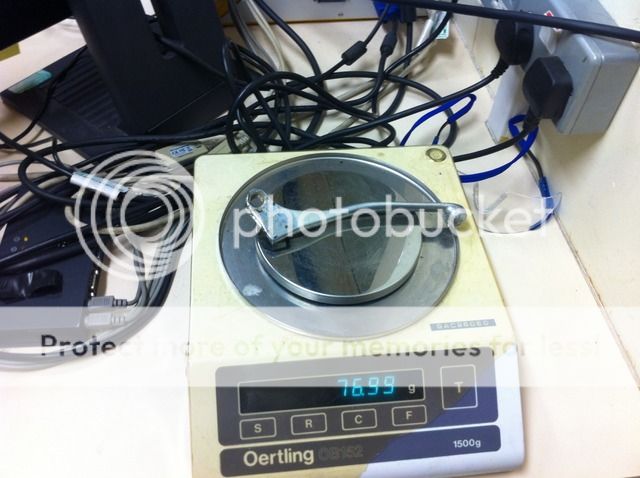

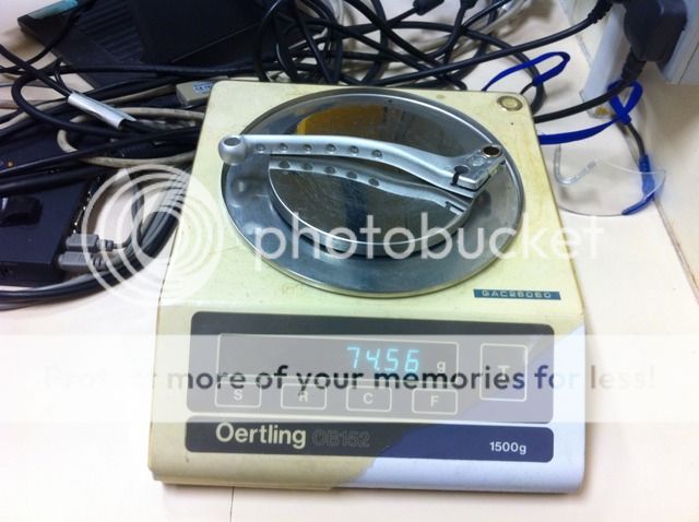

I have an old set of levers that were looking very scruffy so I decided to attack them with the aim of making them lighter and less wind resistant.
The method works for GP bikes so why not mine, that and I was going to throw them away anyway.
Old school cool or stupidly unsafe?

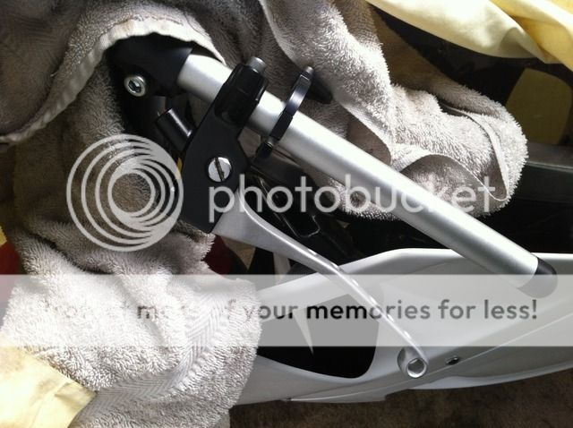

Recently won a new secondhand clutch lever and perch off the bay because it looked good in the picture, seller failed to mention it had been through the gravel in the description though. Which made more work for me.
Anyway, all stripped, painted, regreased and bolted up.

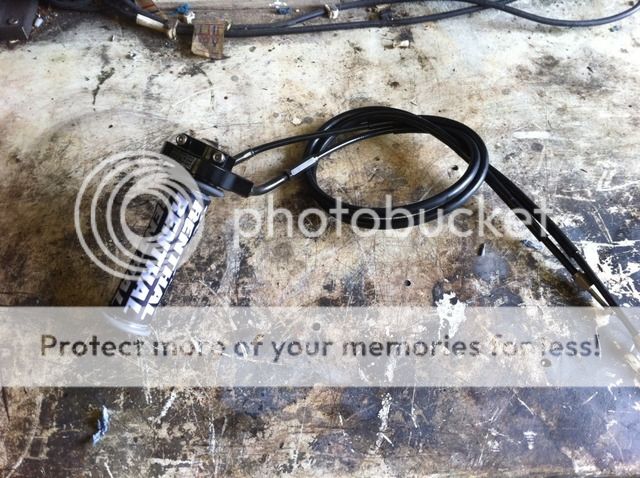

The billet quick action throttle arrived, nice cheap new part and dug out the throttle and clutch cables.
New grips and guards, didn't want to skimp on these tbh
Oil'd, greased, glued and lockwired together

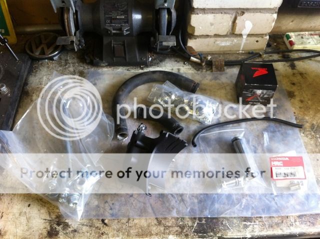

Bit more engine prep before it goes into the chassis. Filter, water pipes and bolts with the threads run through with a tap all done.
Need to sort out the loom now
