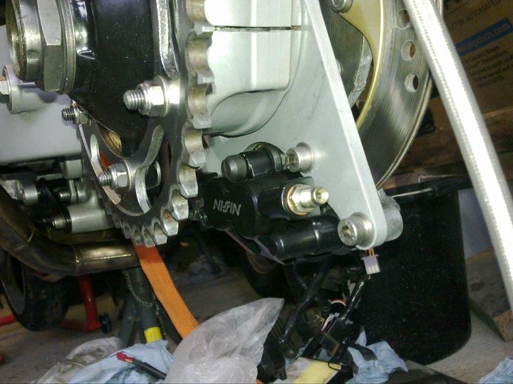

Thanks Guys, the caliper i spent about 8hours, paniting cleaning polishing etc,

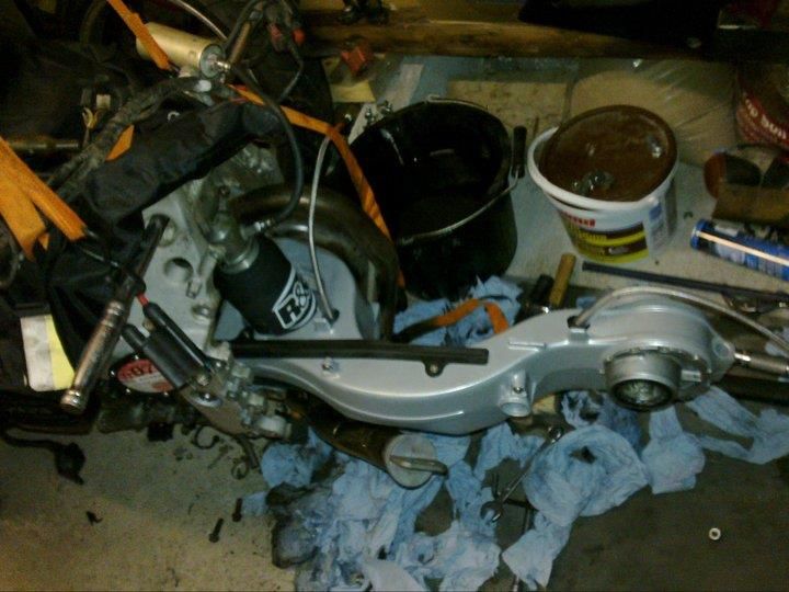

Todays Efforts The Rebuild Begins!
cleaned all the crap off the frame and engine casing,

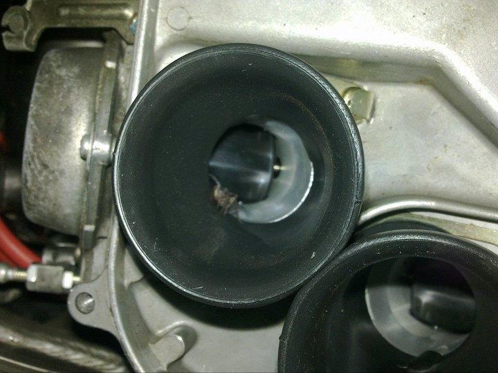

i Found a Lodger, hes now in the garden after i had to use long nose pliers to grab a leg. i like spiders honest

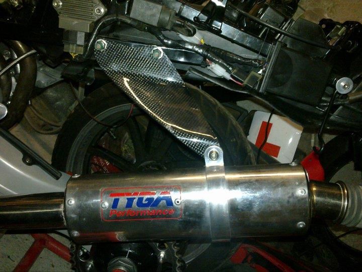

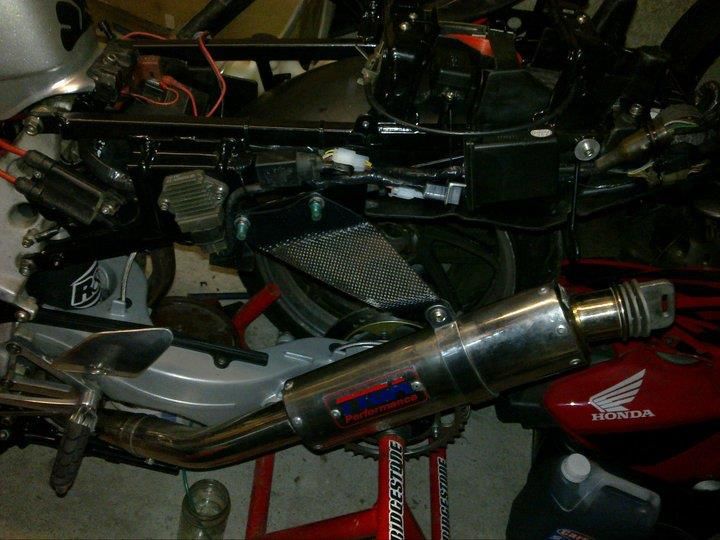

Tyga can fitted with Gav @ Jap4's Baffle TO BE TESTED

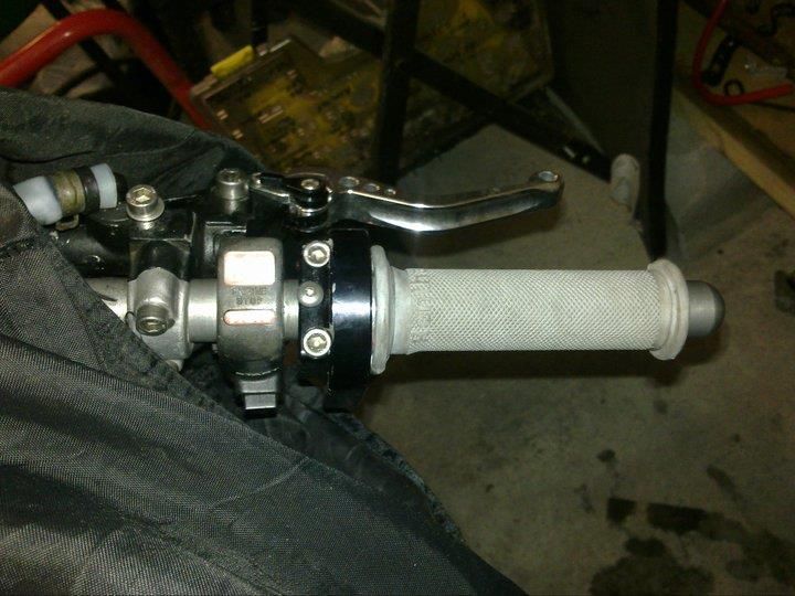

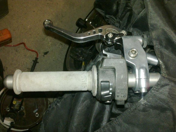

Grips Thanks to Rhory

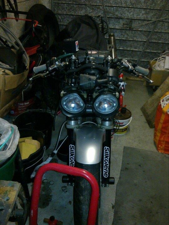

this evenings work.

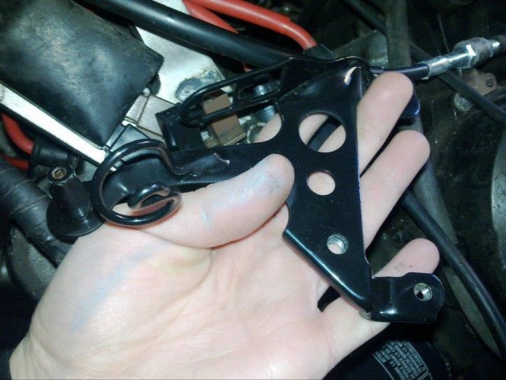

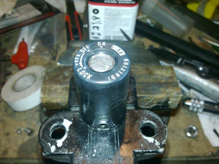

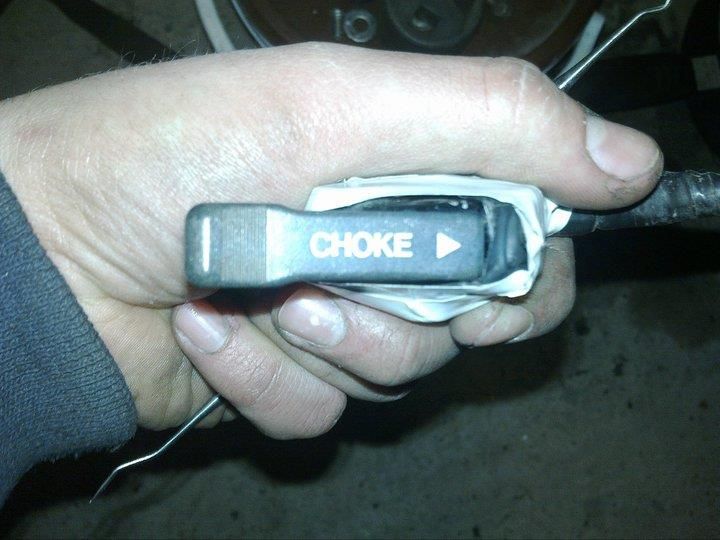

put choke, front coil, idle screw brackets back on after being powder coated.
put front HT leads in/on
reffitted ignition key switch, after painting the letters, and lubing up the steering lock, adjusted the damper to get better lock to lock,

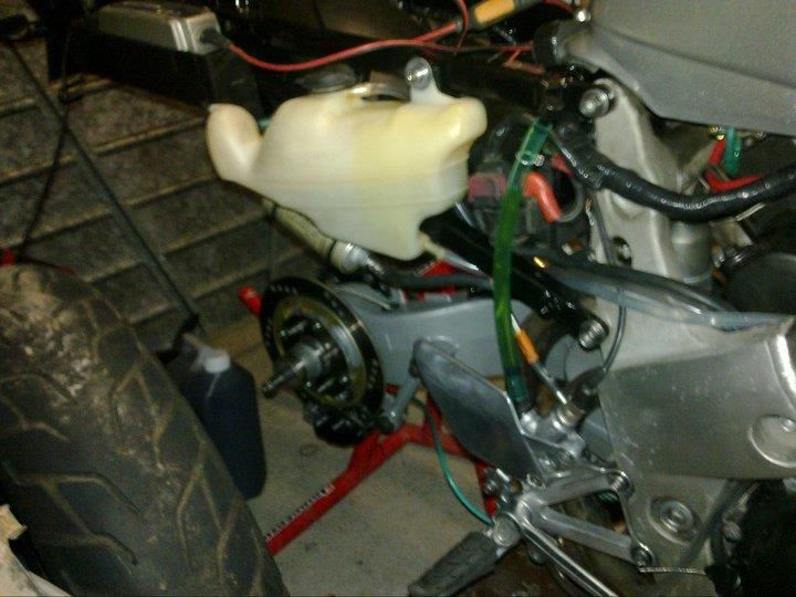

fitted the rear hose to the rear caliper after yesterday confusion

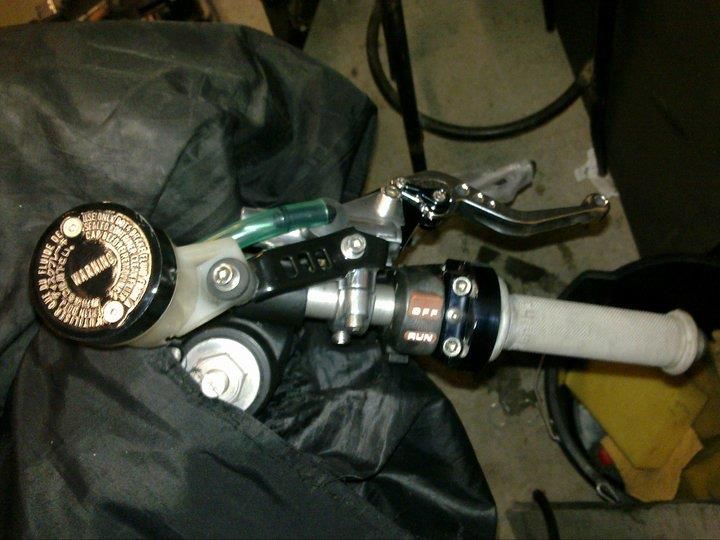

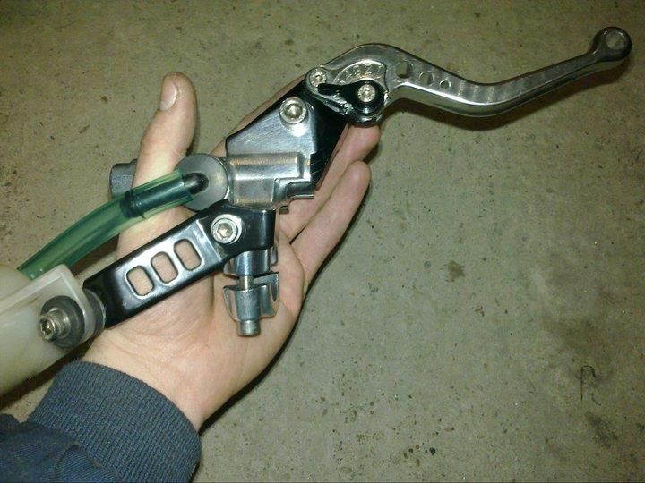

removed and swapped the front M/C for my new polished one,
just waiting for double bleed banjo from royster (im waiting on you roy!
awaiting bolts for side stand, rear sets & sub frame.

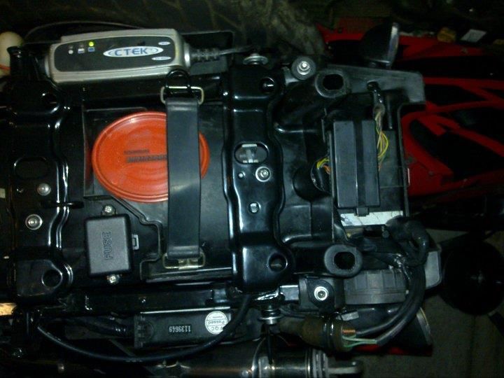

have also scrubbed the sub tray down got read of some 22yrs of dirt and grime.

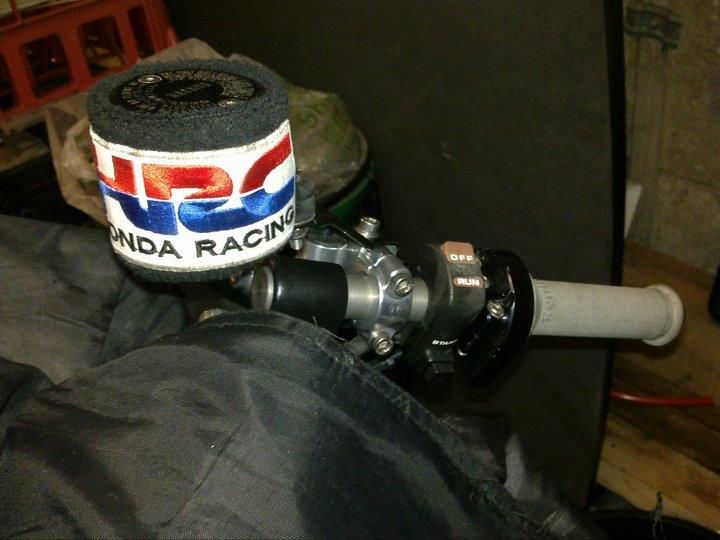

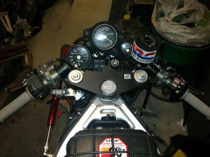

i started the engine saturday,
put the kill switch to off, cranked the engine a few times to make sure the new oil was pumped about in places,
full choke, no throttle dry carbs empty pipes etc, so took about 30secs for the juice to get into the carbs,
then she fired into life but stalled a few times, i found it hard to get the right level of pressure on the quick action throttle, due to the increase in throttle movement,
once she got going got her idling at 2k, them dropped it down to 1.5 then 1k and she was great, revs so much freely through from 5k to 10k i guess with thanks to the K&N panel filter in.
im happy sounds more healthier than when i took it of the road in november.

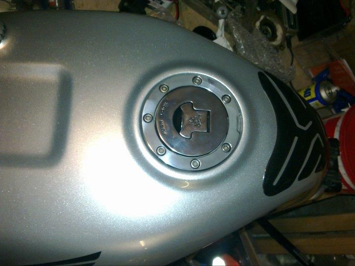

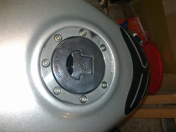

Polished Petrol Cap,

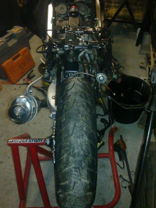

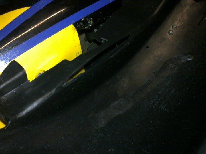

What size tyre has been run on this to get this damage this is the swing arm side of the tyre!
im running 150 BT92s and havent done this its miles of that sub tray
New Carbon Hanger - Thanks Marcus57,
powder coated subframe, A" Stainless bolts everywhere, newly taped up loom, reffited alarm, powder coated luggage hangers, i put those pipes over the threads on the subframe as i cut myself on one of the really sharp threads,
New NGK HT LEADS from mr Rick O fitted, did away the crummy old un's

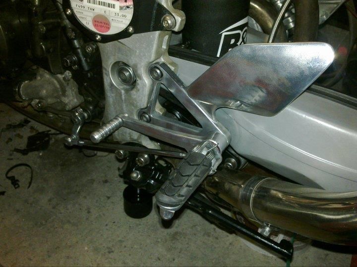

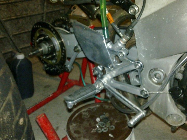

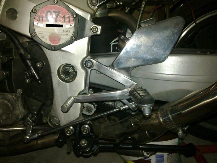

polished hanger/rearsets, Race toe pegs, the OEM ones had been gravel rashed and bold rubber, the pegs had no grip also bold, so upgraded for some replica CBR6 ones for £15 at M&P, polished up the original gear link rod and very impressed with the end product.
i have a tool strap at last! thanks to Geoff cheers mate

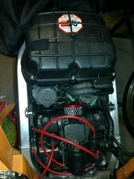

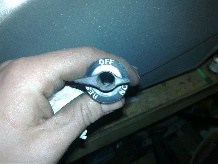

Again new HT Leads, Powder coated idle bracket, choke bracket, repainted choke lever, petrol on of res lever too, new clutch cable

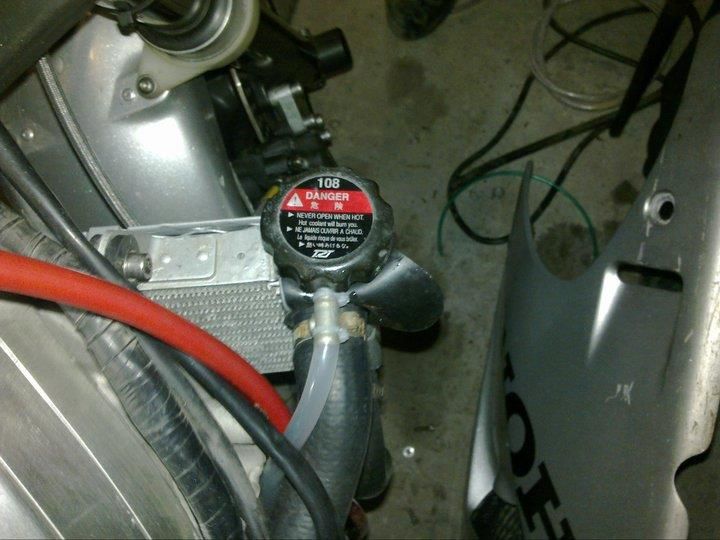

a new shiny rad cap recognise it? no? CBR 125 rated at 16PSI
