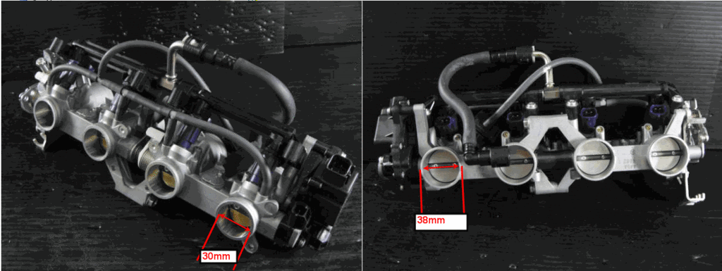

Michael,
I'm consider GSR400ABS throttle bodies for my cbr400rr EFI conversion. Looks like they have 32mm inner diameter and include all requred TPS, injector and etc. This is just FYI. CB400SF Revo EFI is impossible to find now....
[img]http://img283.auctions.yahoo.co.jp/user ... 644106.jpg[/img]
- Posts: 1160
- Location: Seattle, USA
Re: RVF400, race bike,never ending story
Michael,
Looks like GSR400 EFI will fit - this 4 line, but you can easy find all you need TPS, air box, fuel pump and wiring loom as well. Here is measurements.
http://i464.photobucket.com/albums/rr4/ ... creen1.gif

But you have to fit the bodies on a V4 engine, i don´t know how you can make the linkage. The loom? and the ecu? TPS is not a problem.PARUS wrote:Michael,
Michael
- Posts: 1160
[quote="mruehl34"][quote="PARUS"]Michael,
http://i464.photobucket.com/albums/rr4/ ... creen1.gif[/quote]
Michael[/quote]
Argon welding make miracles :))) And I'm more lucky - I need to fit this to NC29 engine and line. I only need to change length between throtlles. But I think we can fit it to V4.
The question I'm worrying about now - how to fit camsharft sensor. I't possible to run without it, but fuel consumpition will be more.
Michael[/quote]
