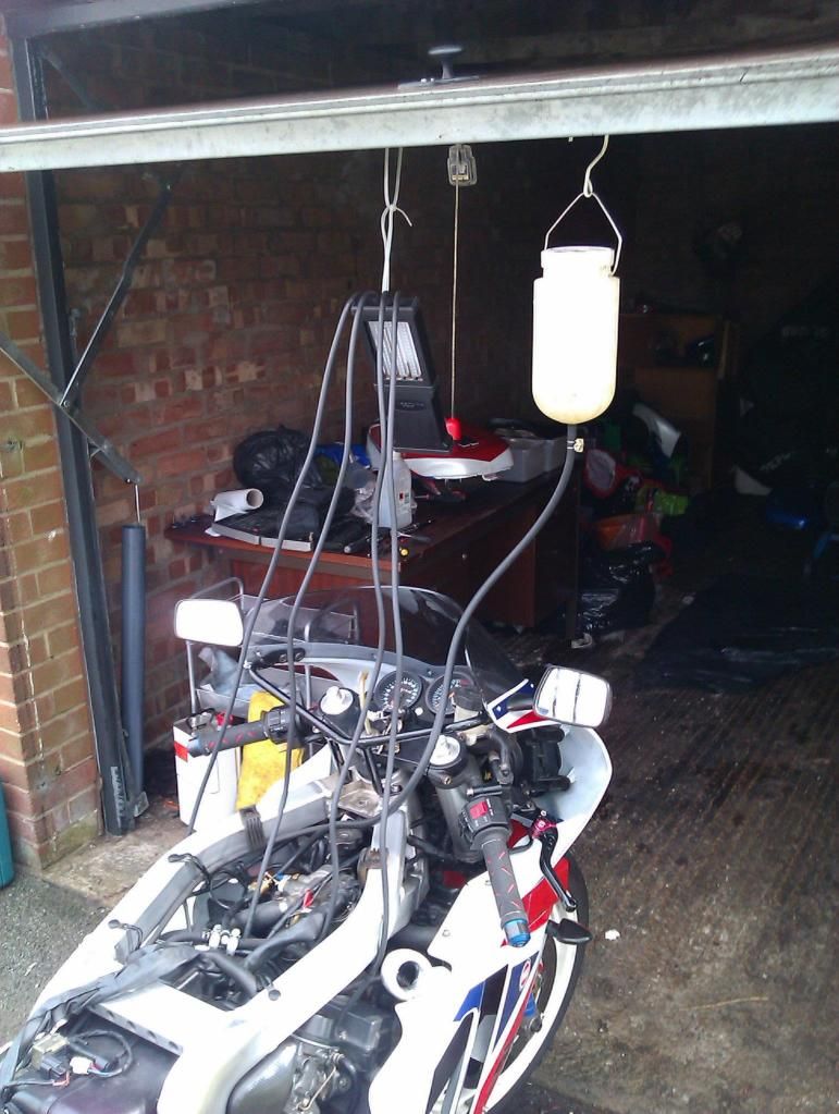

Carb balancing is a right pain in the back side to do on these because of the angle the carbs sit. Have to make sure you get a really decent screwdriver for it that fits perfectly. I bought a morgan carbtune awhile ago and it has already really paid for itself, they state that you should balance your carbs about every 5k miles or every time that the carbs have been disturbed.

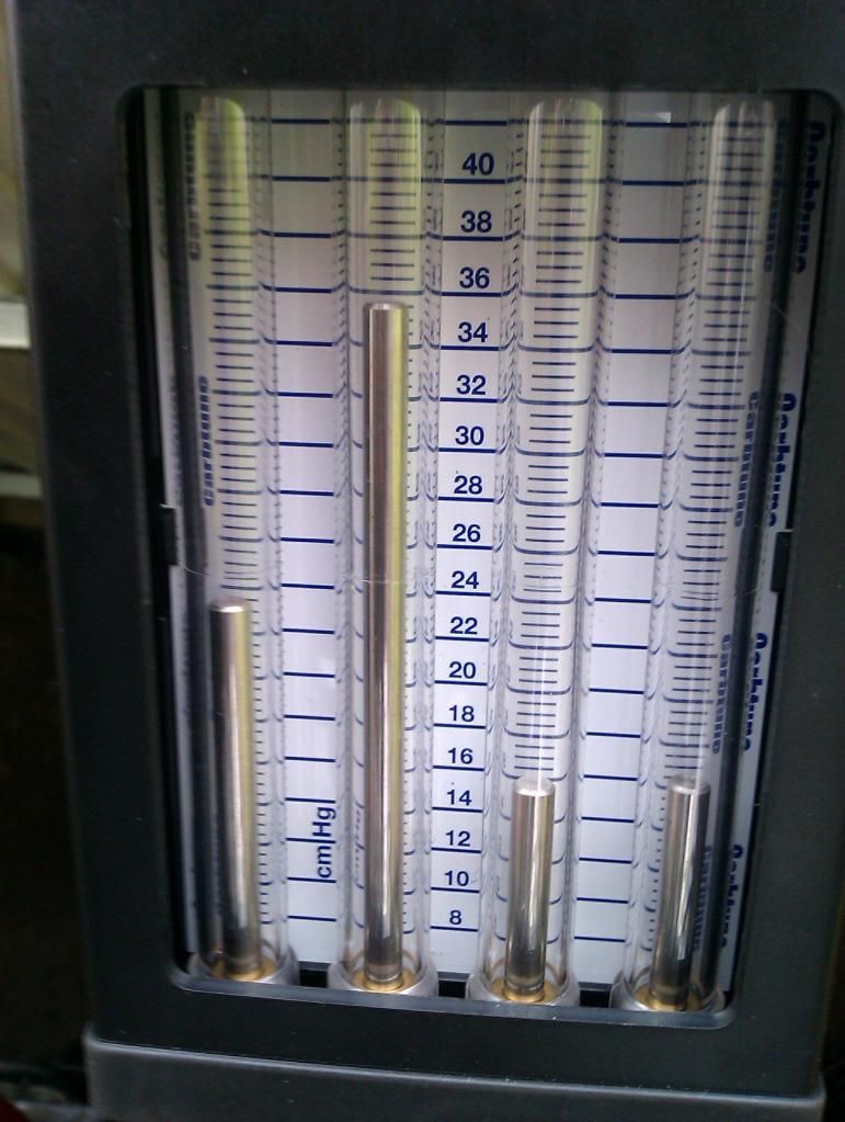

I did balance mine @3k RPM but that was only because it wasn't idling for poop but looking at the readings it was at it was no wounder why, once they were balanced it felt like a new bike.
The set-up i used;
It really helps in buying a separate auxiliary tank do to this, you will have to make a T piece though as there are two inputs to carb.
Before balancing;
After balancing;
