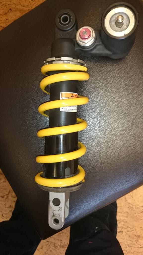

@Andy - What settings do you put the shock at? i got a k7 750 rear shock on mine, I have SP forks on front and i feel that i have them set-up to an ok setting. But back end feels bit too stiff for my liking, getting throw out my seat allot on bumpy roads.
@guitarman - mine went straight on however i do seem to have a clearance issue at the bottom, however i have had it fitted for nearly two years now and its not broke yet
