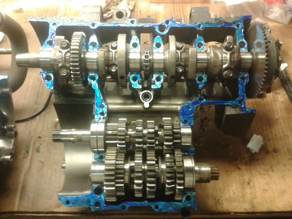

Hi guys
Theres a clunking /knocking noise out of gearbox when second gear engaged ,also very slight in first and neutral.
I suspect teeth missing off second gear ....
Has anyone got pictures of a gearbox split or engine out with gear cluster visable ???
Iv had bike a couple of years now and if it wasnt for the info of this site i would of burned my bike ..Thanks everyone....
When its running right its a TROUSER FIREWORK Anyways if it is just second any ideas were i could buy second gear or complete cluster ???
