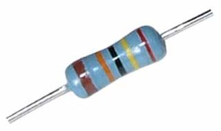

guys, the resistor we are talking looks like this? i googled online for info. i noticed there's different power ratings. other than 1.5k ohm, what other specs i need to take note? thanks. been too lazy recently. will start tracking the wires soon. :grin:
