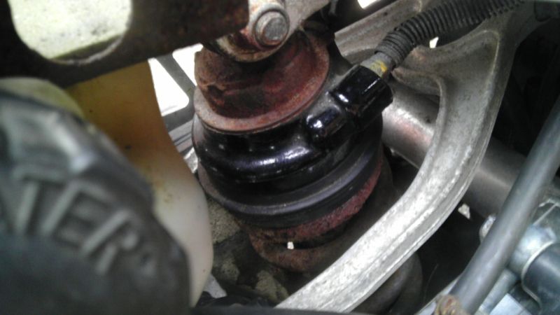

Mine is rubber ducked (think its been living at the bottom of a lake!).
Does anything else fit? Hagon do one for the F but im not sure if thats the same as a B.
Any help would be appriciated.

If you post up some dimensions i have later model shocks and can compare for you.

I was in the same predicament as you. My shock looked as if I fished it from the bottom of an 19th century shipwreck.
I found that a CBR600F4 shock works fairly well, but requires a small amount of machining to get it to fit.
Basically you need to find a shock with a 12" eye-to-eye measurment and both sides as eyelets rather than one as a fork. I can't recall off the top of my head, but the CBR shock was the best bang for my buck, as I picked one up for under $40 USD shipped, and have access to a machine shop. I wanted an upgrade and wanted full damping adjustment as well as preload.
