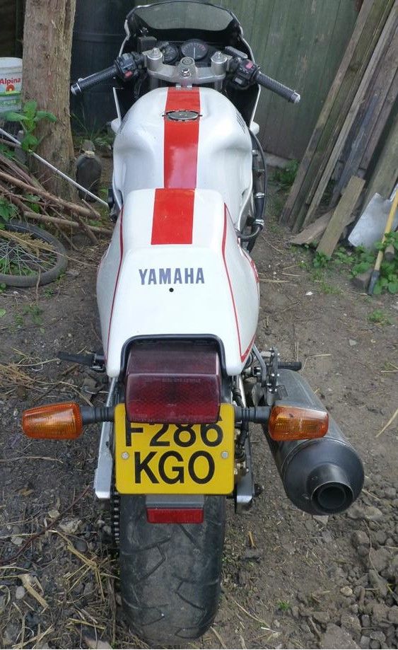

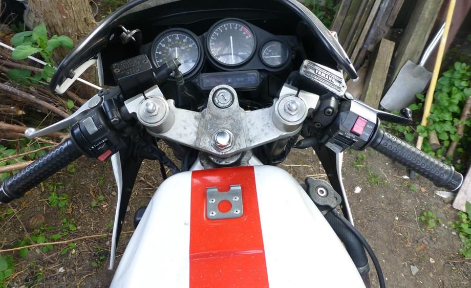

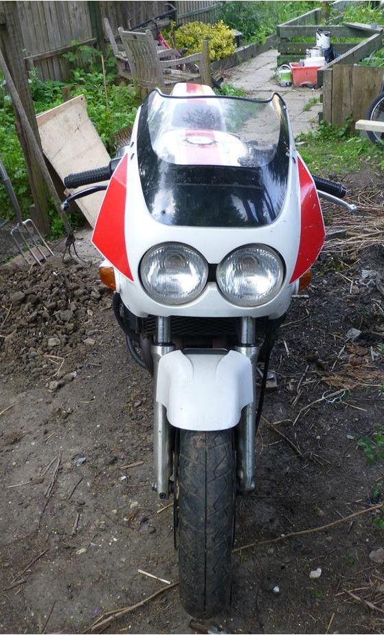

Well I was getting bored so when this came up for buttons I couldn't resist.
The original plan was to just break it for the 2Tk tank cover and seat unit/subframe.
The very knowledgeable Kayla informed me that the engine is Yzf 750.
Unsure if there should be an r behind that ? (someone who knows these may inform !)
Well anyhow,the carrier has just delivered it from Surrey.
It runs,has a working Exup fitted along with a what looks like a FZR1000r rear arm and a 17" rear wheel.
The tank cover and seat unit need a little work and deserve a repaint.
So thats about all until I have time for my own pics and an update.

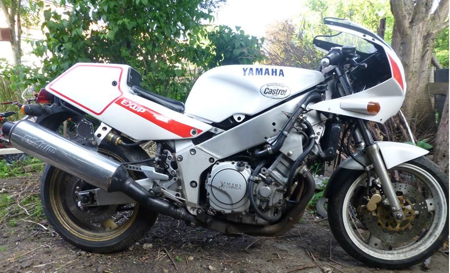

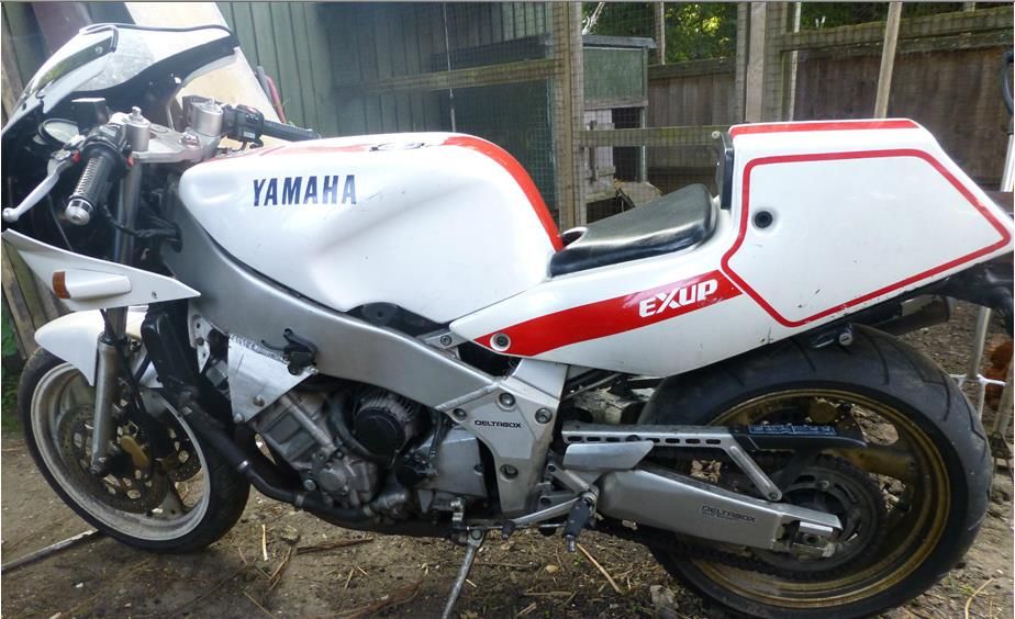

Yes - the FZR400R SP 2TK was an SP of the Genesis but it also formed the base model for the 3EN bikes that came after it. They had soothbore carbs and the usual SP stuff like close ration box adjustable suspension, lighter valves, single seat, the 2TK has an alloy tank shroud the 3en were steel.LiteTekBlair wrote:So it is the SP version of the 1WG, is that right?
Except yours has a YZF750 engine. Could make a nice special.
The YZF750 was either a R or an SP version, the SP had flatslides, the later R versions got the adjustable suspension. The carbs will be interesting on this one, they were to wide for the 3TJ fame. Before you do a lot of wotk check the headraces aren't ovaled from wheelies.

"The carbs will be interesting on this one, they were to wide for the 3TJ fame. Before you do a lot of wotk check the headraces aren't ovaled from wheelies."
I did notice last night that the frame had been messed with and reshaped in order to fit the carbs.
There seems to be about 5mm. clearance each side.
I thought exactly the same as you, on the steering head,especially with weak fork springs.
Not the optimal conversion.I know;but I think something can be made of it.
Just a pity that another 2Tk has been butchered.

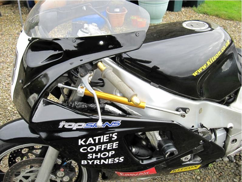

It is, and while it'll never be 'standard' again it could be a really cool sleeper. Get rid of the mahooooosive can (it's a dead giveaway!) and try a 3EN2 front fairing on it with 3HE (flat?) headlights. It'll look like a cross between an OW01 and a ZXR750willandrip wrote:Just a pity that another 2Tk has been butchered.

In fact, sell it on to me, I have some Thunderace forks that'd go nicely in it and it'd make an awesome post classic racer! Swap for a 2TK rolling chassis, one careful owner?
