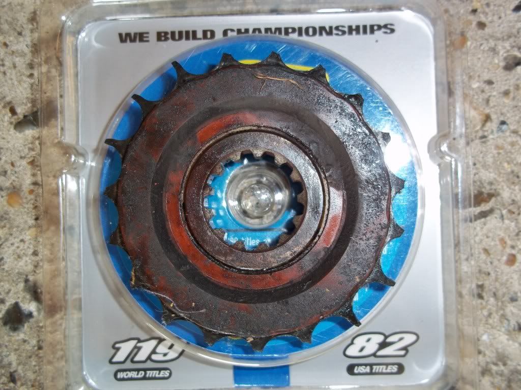

Recently changed my chain and sprockets for the MOT, turns out the front looked a little like this...
Only 5 teeth left!! Thought i could hear a knocking noise, must have been slipping over the few remaining teeth
Replaced everything with a standard 428 chain and sprockets

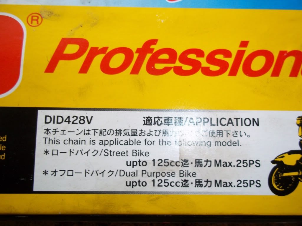

The chain is an o-ring from DID, i put it on with no problems but as i was tidying up i noticed the packaging said this:
Max 25 PS?
Is this something to be worried about or is it aimed at more modern bikes?

Nope Yamaha used a lighter chain - as long as it's an o-ring you'll be fine.
I knew somebody with a 3en2 who put a standard size, standard duty chain on after having read an article that said it would be fine as long as it was lubed. It stretched on every ride he took, lasted about a month !!!

Ok, cool, something less to worry about 8-)

Evilchicken0 wrote:Nope Yamaha used a lighter chain - as long as it's an o-ring you'll be fine.
Guilty as charged. Although you are making the chain sound better than it was. Lasted a fortnight and stretched about half inch every time I went anywhere on it.
