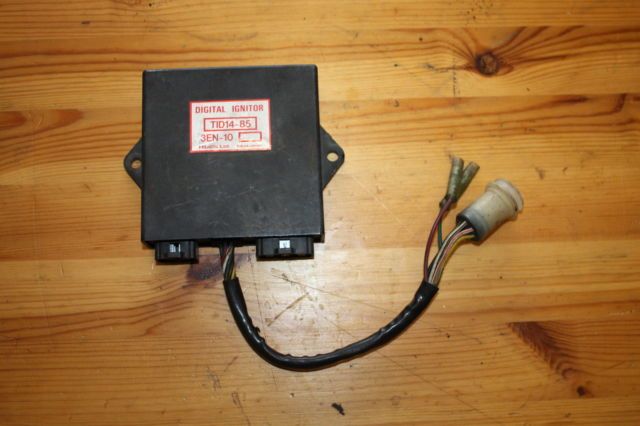

I had a look at the linked ad yesterday to see if the wiring was going to be plug and play ; it seems not.
I have to assume all the 3TJ TCI boxes are the same wiring otherwise the 4DX unit would not swap over ?
It seems strange for Motrax to have made and sold two different types of derestrictor for the same model (3EN)
They are designed as plug/play; no cut/shut should be required.
It does seem that the 3TJ instruments are different wiring to the 3EN2.
http://www.ebay.co.uk/itm/Yamaha-FZR400 ... 2a28d3e33e
The 3EN2 does not have the 2 separate bullet connector tails shown in the ad above; this may be where the second type of derestrictor plugs in on a 3TJ . (cannot tell wiring colours from pic though ! )
What type was the unit you sold to Kayla last year ?
