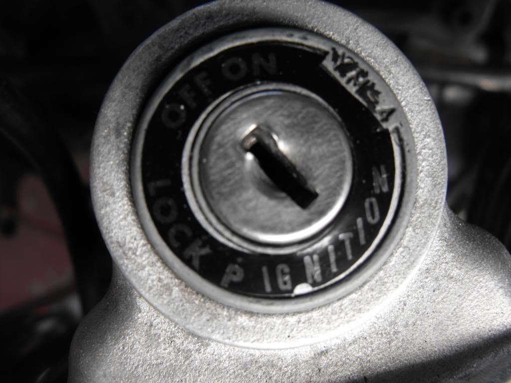

The key mechanism is fine but the silver metal circle where the key pushes into is damaged giving the appearance that somebody has shoved a screwdriver in it. And the outer where it should say 'lock' 'on' etc is tatty and rubbed off.

Tidy up the escutcheon plate on the ignition using a ground down slotted screwdriver as a dolly/lever and try to reshape ;use a ring spanner to smooth out .
Ignition decals can be obtained here;
http://www.ebay.co.uk/itm/RD-RZ-LC-YPVS ... 416fa024b2
and will tidy lock up considerably.
This was a right mess initially but tidied to an acceptable condition.

The metal escutcheon keeps falling out and won't secure.
I will try and get it looking reasonable and see if I can secure it.
