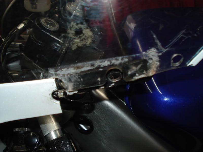

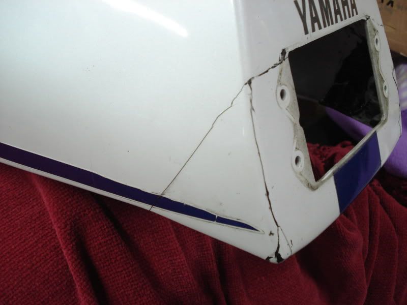

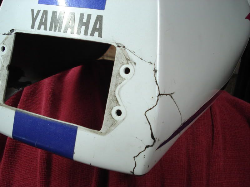

Some pics of the problem areas on the bodywork.
Nosecone
Tailpiece

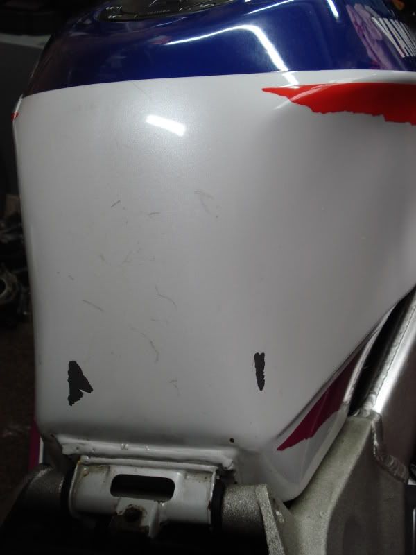

Tank (two small patches of paint has peeled away on removing shite tankpad.
What do you guys think, Repairable??

Its all repairable, get a scrap normal nose cone for the missing bit on yours. The seat unit could be plastic welded but you'd never hide it unless you repaint it, is that a pearl paint that white?

Do you think the tank will need a full spray?
Yeah it's pearl white.

Not if its just those 2 patches in the pics. being pearl you might notice it in the right light but its not in a noticable place.
Just checked RS paints and they list a silky white for FZR's which is pearl

Hopefully the tank can be touched up and i will put a tasteful tankpad on it which will cover it.
will just keep my fingers crossed that the decals are still available so the tail and nosecone can be sprayed.

i fixed a broken piece of fairing similar to that, i fibreglassed behind it, good and solid, then filled and sanded before repainting, couldnt tell it was done from the outside.
