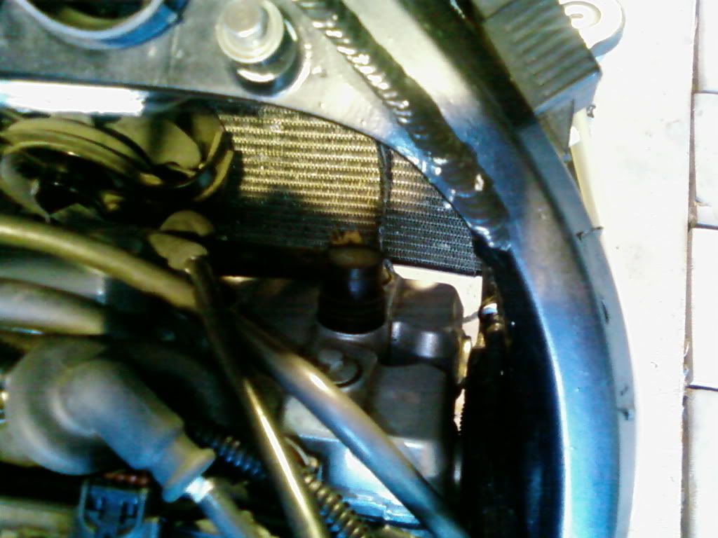

Hi,
Maybe somebody made a research which COP (coils-on-plug) can be use in our cbr400 engine? I don't really care for now about dwell time, resistance/inductance and so on, because my EMS module able to setup for any of these parameters. The main point for me is size - I have tried Kawasaki ZX6R COPs and it looks like ok, but I like little bit smaller length.
Here is kawasaki.
Maybe something like this size:
For those who're interesting to use COP with your stock ignition system, you can use Bosch 0 227 100 124 which allow you to get very good spark in wasted spark mode at your cbr400. Here is link: http://www.microsquirt.info/Bosch_211.htm
Here is kawasaki.

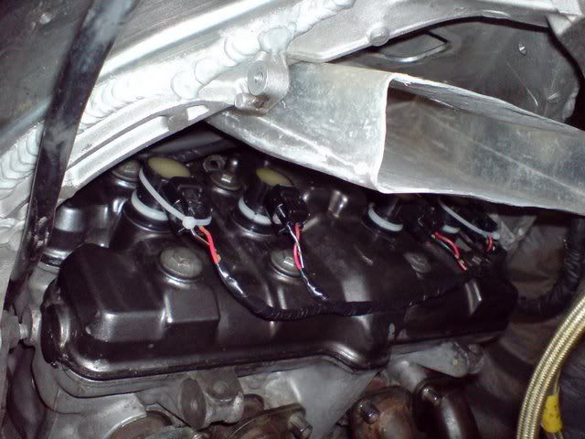

Hi , its been covered loads on here and i run cop's on my bike. You will find it difficult to get a shorter cap for the look you want, i use the cbr6 and they stick up a little due to the 6's having deeper pockets than 4's due to larger valves etc. I run my cop's in series and although the voltage drop from series wiring means i only get 6v at each coil they still work better than the old twin coils. Im interested in the Bosh unit you posted as it looks to allow parallel wiring without the high amp load you would get if done normally, i think! if you wire in parallel with the standard set up would get components burning out due to the large amp flow.
