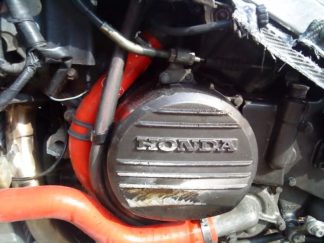

With the fairings removed you will see the left hand engine casing which will also need to be removed.
once removed it should look like this

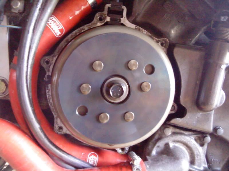

you can see the standard NC30 flywheel which covers all the windings - by doing this modification you are effectively reversing this and lightening it by using the lighter rotor, thus giving an improved response from the engine when whacking the throttle open!!

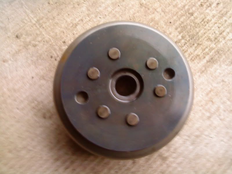

Next you need to remove the fly wheel centre nut. - this is easier said than done if you don't have the correct tools. A friend helped me with this using a holding tool to stop the flywheel turning as I undid the nut.
At this point you may need to use a flywheel puller to get the flywheel off the shaft - however - I left my bike overnight and returned to find that it had fallen off of its own accord!
This is the flywheel you will need to remove and set aside (hopefully) never to be used again!

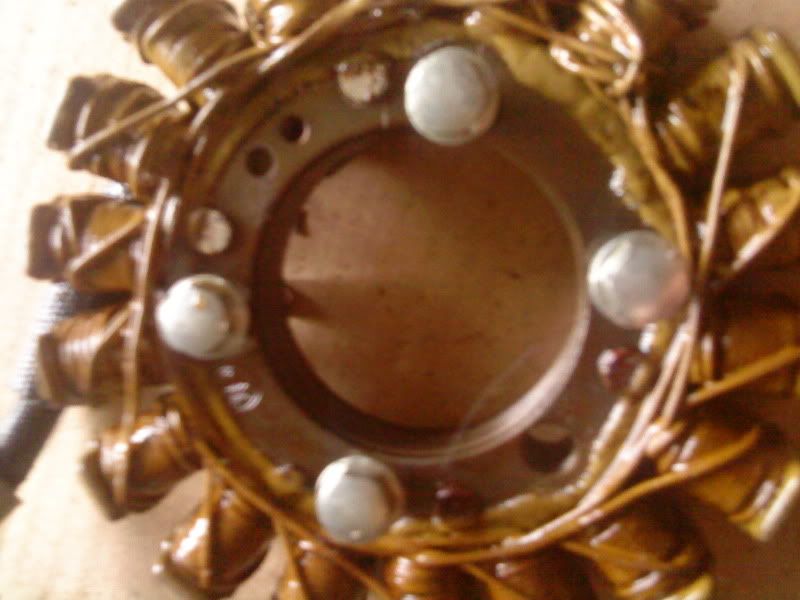

you will now be faced with the windings which are held in place with 4 bolts -
Disconnect the windings/alternator from the loom by tracing the wires back to the right hand side of the engine.
You can now remove the 4 bolts holding it in place and again set it aside never to be used again!

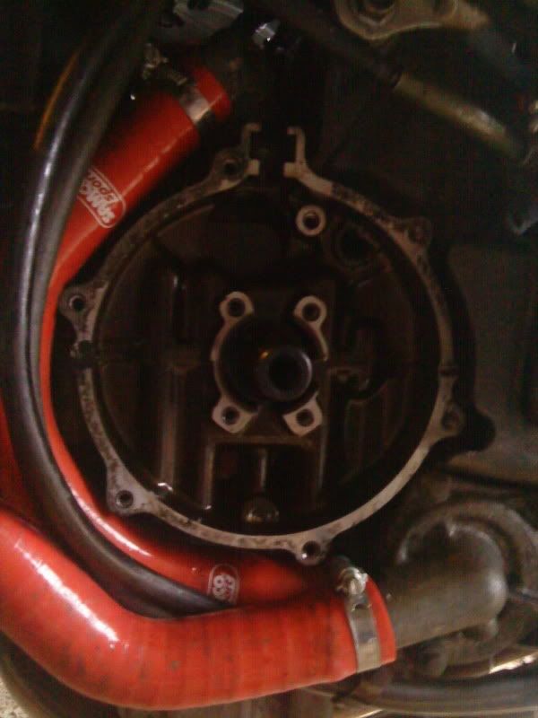

This will leave your bike like this - all ready for reassembly.

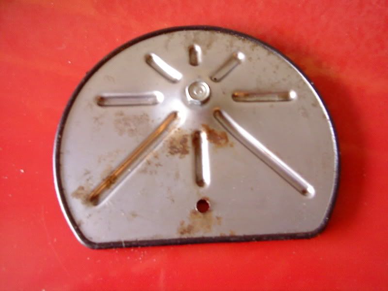

The sound proofing in the engine casing has to be removed - simply undo the bolt and gently lever it out

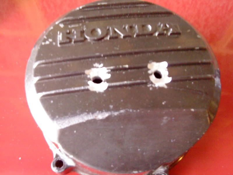

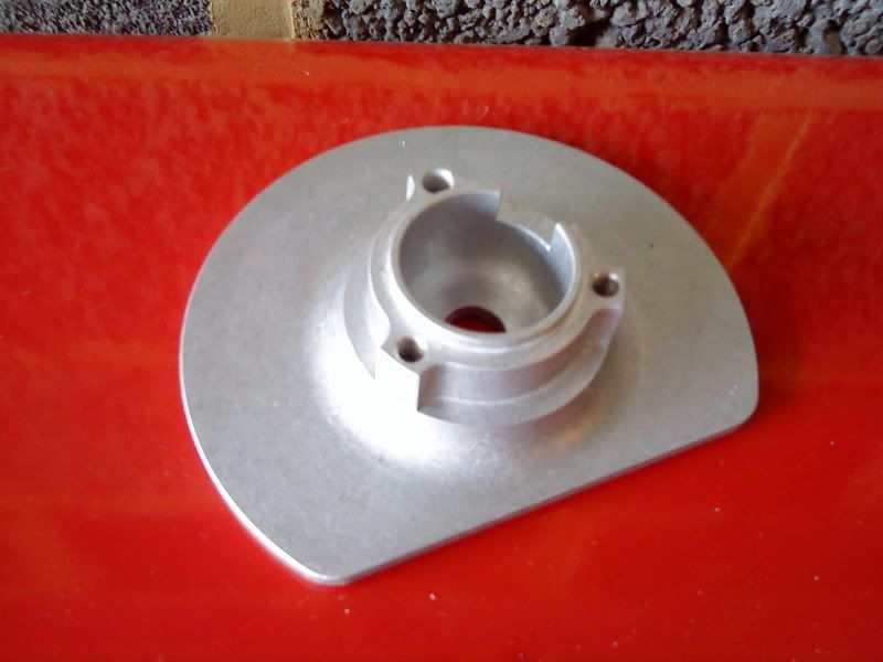

Next insert the adaptor into the casing and mark where the two lower holes need to be drilled.
Adaptor
Casing with holes drilled and fins removed using a dremmelto ensure good fitment of retaining bolts.
a small hole also needs to be drilled internally for the bracket that holds the wiring out of the way of the spinning flywheel.
Fit the adaptor to the casing and secure with the two bolts on the outside ofthe casing.

hi I`m struggling to get the flywheel off ,the 14mm bolt is already out but it still doesn`t move
royster81
Posts: 2509
Re: GSXR Flywheel Mod
Post by royster81 » Mon Aug 27, 2012 12:21 am
you need a flywheel puller.
JC120
Posts: 274
Location: Southern California
Post by JC120 » Mon Aug 27, 2012 2:44 am
Yep you need the puller. It was only $11 on ebay shipped. I just got my flywheel off. Good God the stock one is heavy compared to the 2008 gsxr1000 one.
Posts: 8172
Bike owned: CBR954
Post by Neosophist » Mon Aug 27, 2012 3:14 am
SilverSurfer wrote:hi I`m struggling to get the flywheel off ,the 14mm bolt is already out but it still doesn`t move
You will notice that removing the 14mm bolt reveals a bigger hole. Into this hole you screw a 20mm x 1.5mm pitch bolt to pop the flywheel off.
