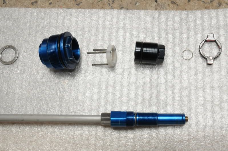

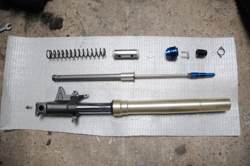

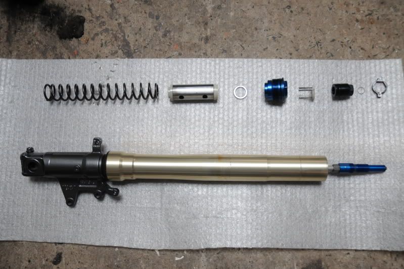

Recently got myself some RVF fork with what I was told were Ohlins internals. Now if its not, I'm not too bothered as I'll fit Ricks kit anyway, but can anyone identify them? There are no markings on the adjusters, springs, valves or spacers, but the fork-tops are not standard looking. Can anyone help?

From the photos they look like standard fork internals to me. The springs look just like the ones in my workshop that we take out when up grading for race use. So, unless the valving has been changed then I'd say that they are stock.
Cheers Mike @ BMC Racing.
