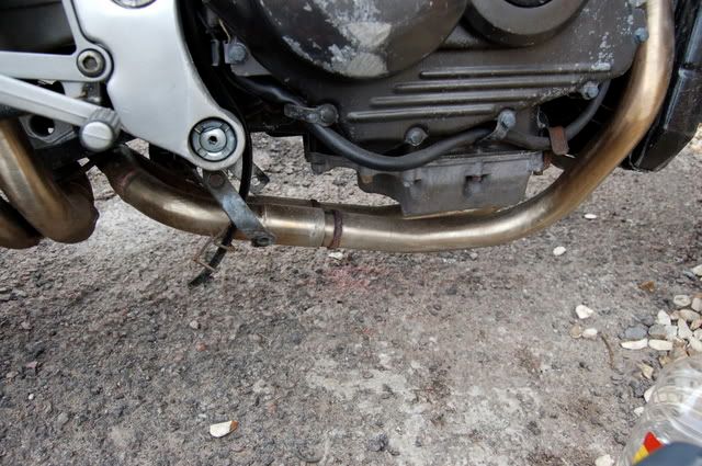

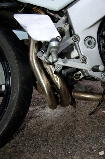

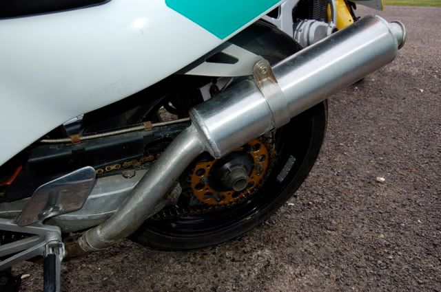

Firstly I need help identifying my exhaust system. I have checked through the galleries searched etc but no joy. I believe part of the system is yamamoto but the end can/link pipe doesn't fit on the system properly. Ideally I am hoping to just be able to buy a correct sized link pipe and end can for the system but not sure on what to look for or what to buy!

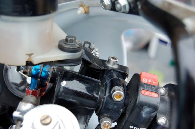

Next problem is the front brake reservoir fouls the wing mirror bolt. I could just shorten the bolt a little but the clamp itself holding on the reservoir looks like a bit of a bodge possibly. Could someone tell me if this is standard:

1106 wrote: Next problem is the front brake reservoir fouls the wing mirror bolt. I could just shorten the bolt a little but the clamp itself holding on the reservoir looks like a bit of a bodge possibly. Could someone tell me if this is standard:
Your isn't standard.
Try getting hold of a standard one, wouldn't be hard if you put a wanted ad in the for sale section.

leanne, that pipe you have is deffo a stainless yamamoto 3/4 system (i have 2)
standard headers and the alloy one peice can. i bet yours has got a bit on the loud side now ? mine sure are
I have just (being collected tommorow) sent my spare alloy can to graeme france asking him to make a new link pipe and can for me which looks far nicer and is quieter. why not contact him and tell him to make it 2 ?
