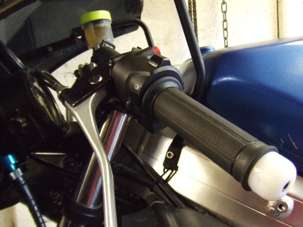

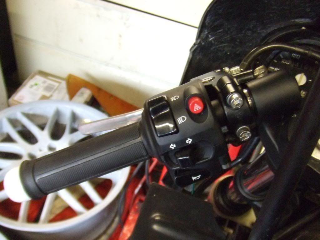

iv'e just fitted R6 throttle and switchgear to my nc30 !!
I sprayed the clipons/yolks/master cyl/clutch lever assembly/fork lowers mirror stay and headlight stay matt black . . . with the fresh modern looking switchgear it really looks the nuts!! and feels pretty 'quick action' too!! althought i didnt think to measure up before i removed the old one (expecting it to be the same) so i got no actual comparison . . . but its definately quicker to wide open
I had to use one r6 throttle cable and one original honda cable (with a small amount of jiggery) to adjust out the slack properly . . . oh and the wiring for the left hand switches took a fair bit of . . . err . . . 'starring aimlessly at the multimeter in a vien attempt at understanding what was goin on inside' kinda thing. In the end i opened em up and drew a picture of what wires went to what switches ect . . . then just transposed my picture onto the nc wiring diagram !! a high power coputer psu connector, a length of heatshrink and some solder saw to connecting em up . . .

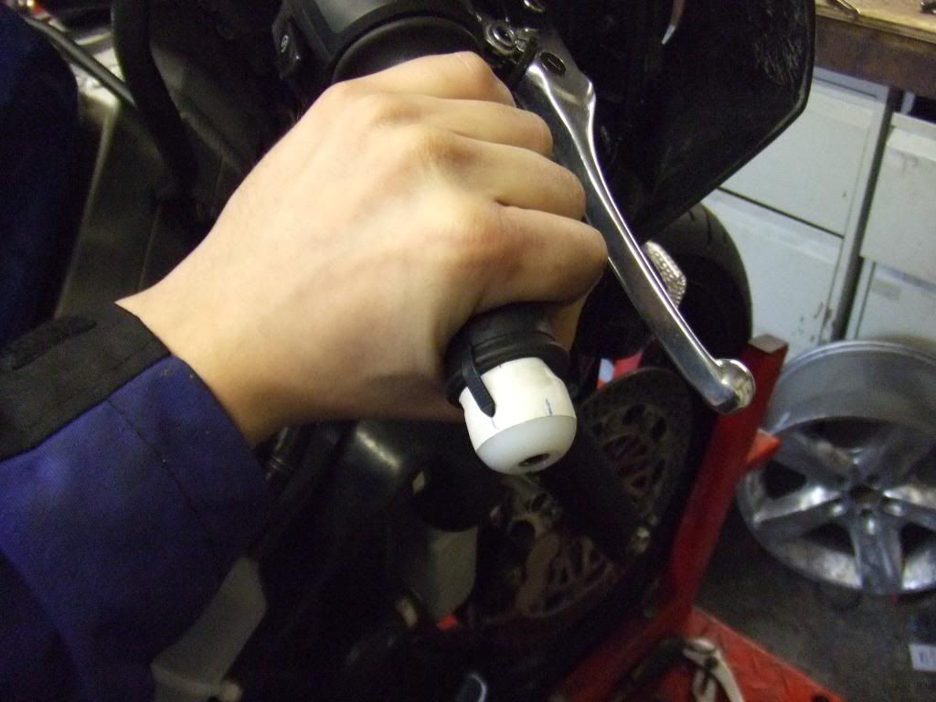

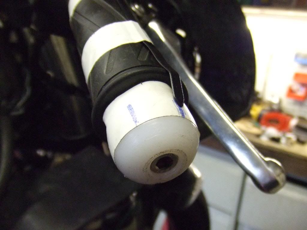

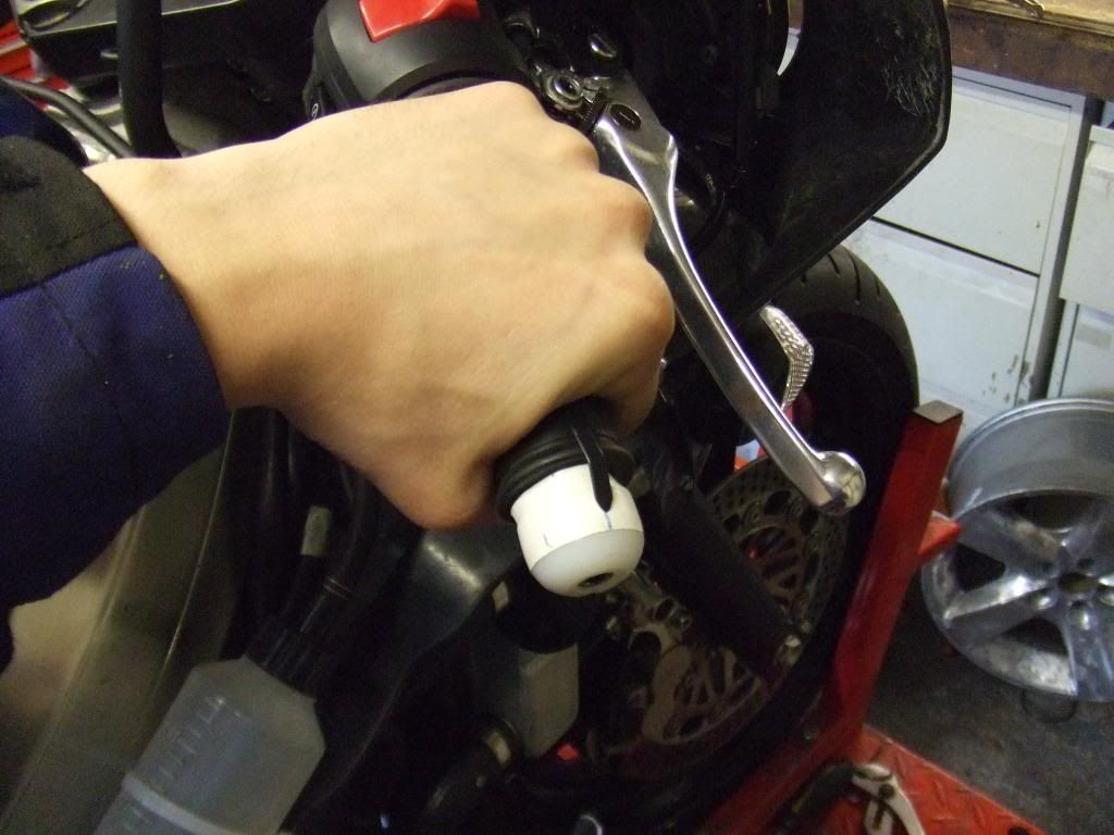

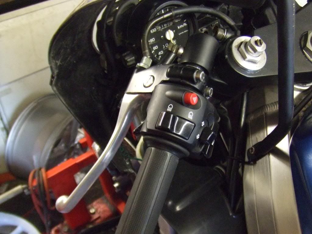

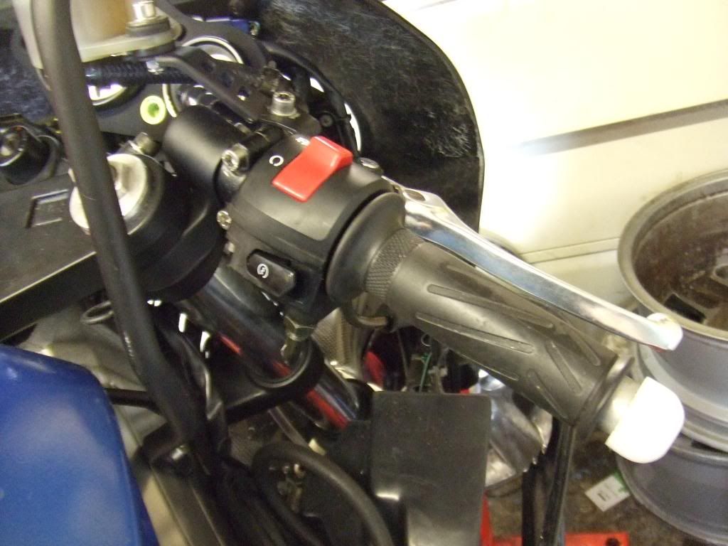

got there in the end . . .
check the throttle action. . .
closed . . .
to full open . . .

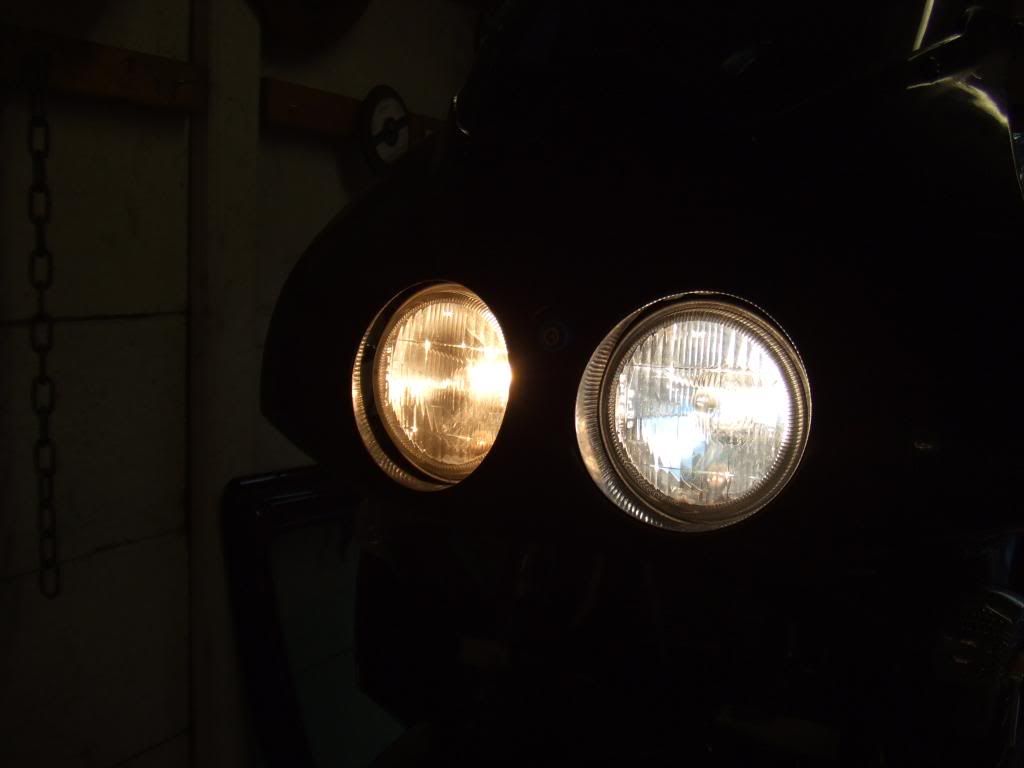

with the new headlight wiring completely bypassing the switchgear i thought i'd uprate the headlight bulbs to a pair of 60w ice white jobbys . . .
What a difference . . .

Post by padawan » Fri Apr 17, 2009 7:51 pm
Jobs a good'un mate looks professional, stark contrast with the 60w lighting which is always good!
