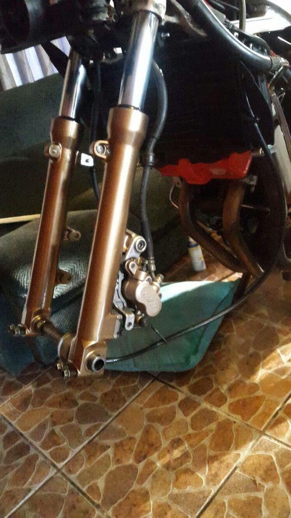

Thanks vfr, did them yesterday, took the whole day, but I did resparay the lowers as well, which took some time, they weren't really hard to do, the anti dive side was being a little biatch getting everything lined up right, but they felt amazing after the new oil and seals went in. I cleaned up every single part and flushed the tubes out with petrol and a lot of crud came out. The old oil looked like charcoal milkshake.
The old seals were knocked in with a flat screwdriver so they looked really bad, probably why they didn't hold up. That should wrap up the mechanical issues the bike had, now it's all cosmetics.

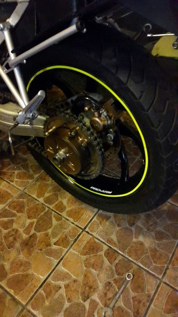

Oh and while I was waiting for paint to dry, I took apart the rear hub, the cush looked brand new and the bearings were all nice and tight, spun freely with no signs of wear, cleaned everything up, polished up the disc, and hit the hub with the same bronze I did the fork lowers with.
She's really starting to look good. You can see the reflection of the hub on the sprocket. (Rear wheel painted too in this pic)
The forks ( excuse the oil at the top triple, I wasn't done cleaning yet..)

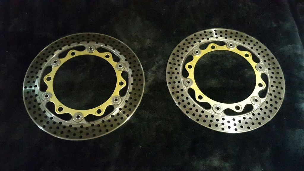

Also did the disc inners while I was at it... masking these took a while
