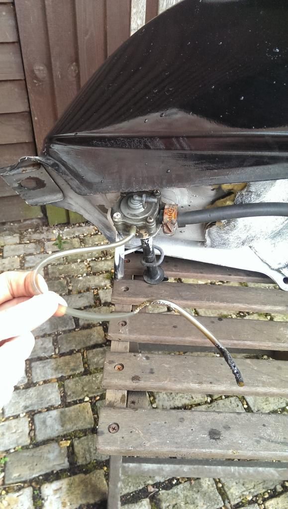

Hi guys, just trying to work out why my NC30 uses so much fuel and have come across this pipe from the fuel tap which appears to go nowhere, but has been destroyed and sealed up by heat damage from somewhere.
Any ideas if its supposed to go anywhere? or do i just need a replacement bit of pipe?

vaccum hose. it should connect to the vaccum pipe on the cylinder
perhaps your tap has been modded becuase you shouldnt get fuel flow without it being connected.

Hose not required, that is just the tap breather inlet/outlet.
The vacuum hose goes on the forward facing tap stub, the other end onto the cylinder head screw in spiggot.
They use lots of fuel, I would not worry if I found no leaks, and the bike went well.
If that [not required] hose is blocked, then fuel flow may be reduced.

I will throw the pipe away in that case, the vacuum hose is still present I just had it disconnected in the picture.

arsey30 wrote:Hose not required, that is just the tap breather inlet/outlet.
That'll teach me for englarging the picture :D
yep its the vent, i dont think they had a hose there as stock.. maybe somebody put it on to bodge a leaking diaphram?

As above, no point in it, get rid.
