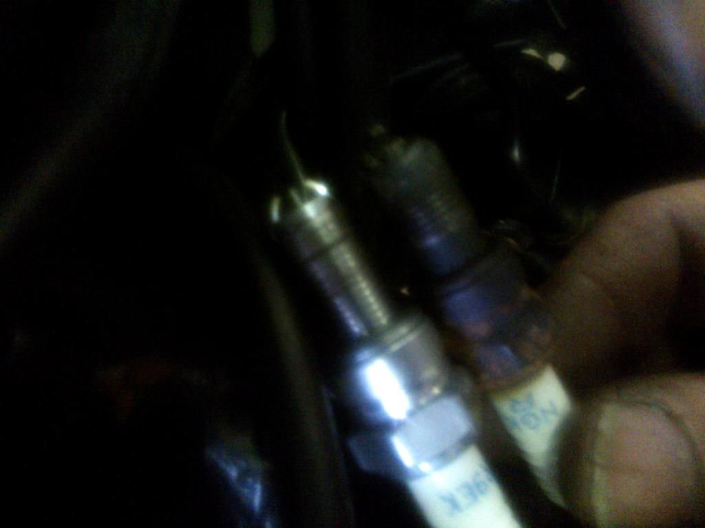

It was then decided to check the spark plugs. #'s 1&2 removed with little effort, as did 4, however the #3 plug was proving stubborn. It finally came out and we were greeted by this:
The plug was melted and what appeared to be an insert had come out with it leaving the plug hole completely smooth.

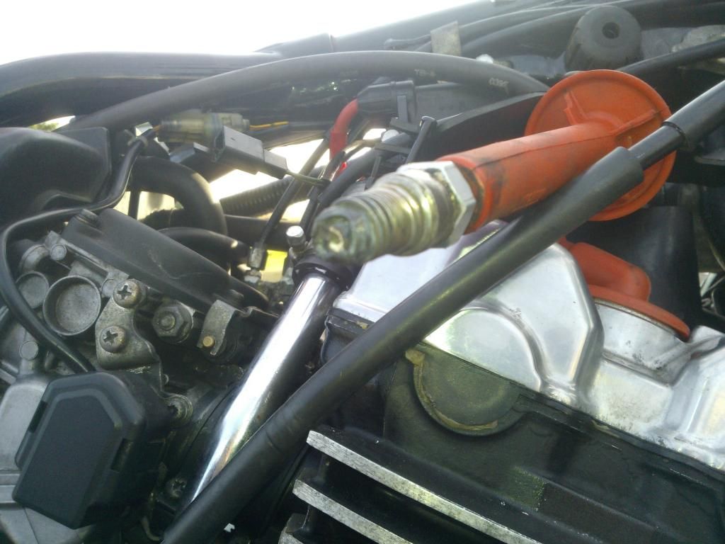

Once back we decided to try and pull the #3 plug again. And we were greeted by a familiar sight:
Melted again and thread destroyed with it!!

Is that the recommended plug type for that model.? Some engines do not take to plug upgrades well.
The heat range (9 ?) seems OK.I would be tempted to use a grade higher on that cylinder until this has been resolved, as a safety measure.The worst is; it will burn out the same as a 9 or foul ( unlikely)
The cylinder must be running exceedingly hot to achieve that damage.
Mixture on that pot must be way off.....lean. Is it possible the inner cylinders should have larger jets for cooling
(pretty normal procedure on a small ILF ) and an incorrect jet fitted ?
I cannot see how electrics would be the cause..... it is a wasted spark set up.... another cylinder would be effected.
The problem should not be caused by an insert on a four stroke..... I have had problems on 2 strokes with
them causing pre ignition/detonation on highly tuned engines.
You must replace the h/coil with a proper insert.... even if a one off is to be machined. The heat is causing the h/coil to fuse to the plug and unwind at removal. Too much metal removed and you will soon need a head.
The exhaust valves will also be getting cooked.
I would be inclined to return it if feasible.....this could very soon warrant a head replaced.....a money pit. :down:
It would be worth contacting the PO ; pretty easy from the log book info nowadays, and ask him a few questions; it may be why he got shot of it.
Good luck; keep updated.
Someone more specialised in the model may help out; this is just a generalisation.

Hey Willandrip, thanks for the reply- what you are saying pretty much coincided with what the mechanic looking at it speculated, he feels it's running very lean. The carbs were all sporting 98 main jets, which I did think seemed small.

Oh should have mentioned the original plugs were CR8EH, and from what I could locate (Wemoto) the 95 S4 takes CR9EK's, and it's melted both.

You would not make the insert brass; it would corrode to the plug threads in that application and unscrew from the head.
Mild steel/alloy far better.
You have already gone up a heat range then.!
What size jets should it have had ?
I would count your blessings if the dealer will accept it returned; many would not consider it ,knowing the problem.
Pity about the shocks; someone here may use them if you are lucky.
Personally I would move that one on ( and I like challenges and things like this)
