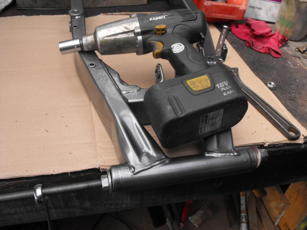

I just rebuilt a bike without a bearing press. Changed all of the wheel, swing arm, suspension, head, and a couple of engine bearings. The only bearings that I wanted to change but couldn't myself was the crank bearings, but as it was a 2Stroke I had an engineering firm do that bit for me.
Actually didn't do the lower yoke bearing now I think about it. My local bike shop did it for a donation to their tea fund.
All I needed was a blind bearing puller from Machine Mart, money very well spent there. A press wouldn't be able to do it. The use of a vice and a small selection of sockets made up for the lack of press. Now I would never advise anyone not to buy tools, but its not strictly a requirement and you do have options.

The hub bearing was easy to remove. Basically stick a socket over it and hit it with a hammer. The linkage was done in a good bench vice at a mates as I don't have one mounted here yet using again a socket as a drift. The swing arm bearings were removed with a blind bearing puller and like with the wheels a liberal application of heat.
The replacement bearings were all new. The hub and swing arm were installed with a socket on the outer race and some taps with a hammer. WD40 was also used to ease them in a bit. Tap them down carefully ensuring they are straight and when the tap note changes you are all the way home. The linkage was replaced in the vice. A few taps out of it first to get it started straight and then the vice to finish as it was a slightly different type of bearing and the shape made it difficult to percussively complete.
