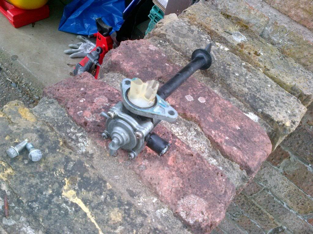

i need to replace the in tank fuel filter as the previou owner had a strange idea about fuel flow!
http://i1287.photobucket.com/albums/a63 ... b15939.jpg
As I have already purchased a RO tap rebuild kit I just wanted to replace the actual filter element.
Does anyone know if one from the 750 VFR's from the mid 90's will fit? although the tap is different, the filter element looks quite similar! [and a hell of a lot cheaper!]

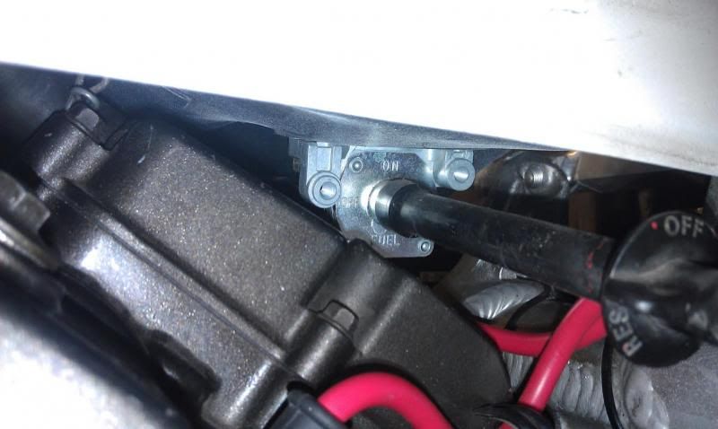

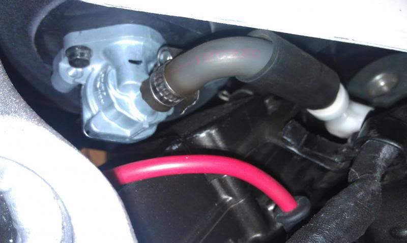

I run a complete 750 fuel tap on my race bike. You just have to use one of the 750 fuel hoses that has a 90 degree bend in it to complete the conversion. Works great!

Not off hand, I'll try to take a pic tonight. It looks nearly identical to the stock NC30 tap except that the outlet points towards the right side of the tank instead of forward, and no vacuum stuff of course.
