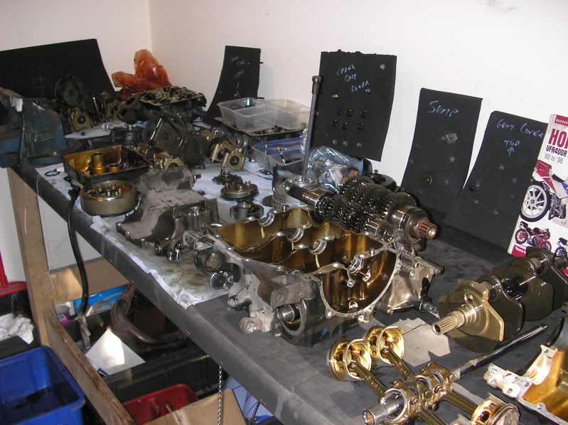

My 2p worth is just to make sure you are very organised about striping the engine down as it will make MASSIVE difference when putting it back together. I got some bits of sheet foam so I could keep all the casing/sump bolts together and in the right place. Everything else was laid out on my bench as it came appart on top of some blue paper roll so I could keep everything in the right orientation and even wrote on the paper what everything was.
Maybe a bit anal and Über methodical - but it worked well for me

When I did mine, every component went into a sandwich bag and labelled. Then stuff was grouped by which head it cam from and put in storage boxes. Cylinder parts went into 4 separate marked boxes. Take shitloads of pics - they will be invaluable when you rebuild it.
One can never be too anal

NGneer's cardboard idea for the bolts is also a good one. I did that recently on another build and it is invaluable
