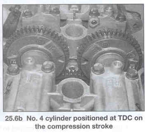

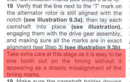

If you check manual there is following picture of camshaft positions.
And note about possibility to miss one tooth.

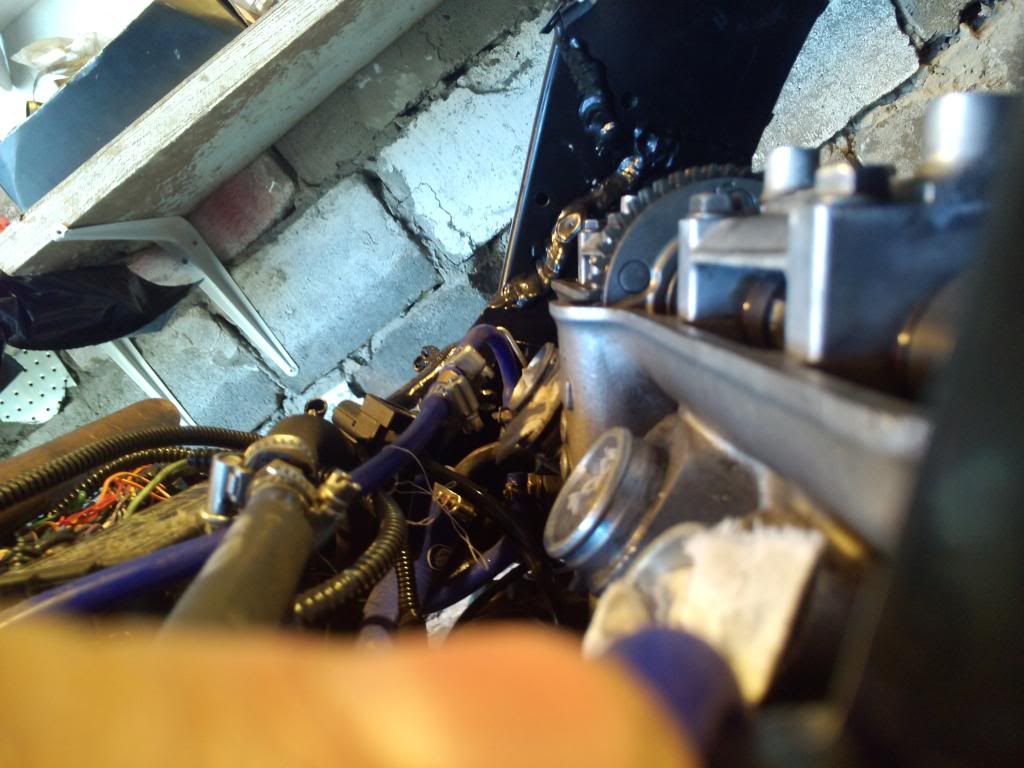

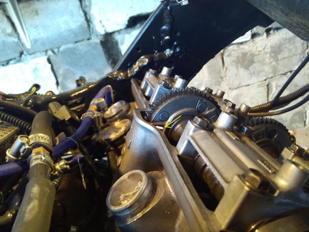

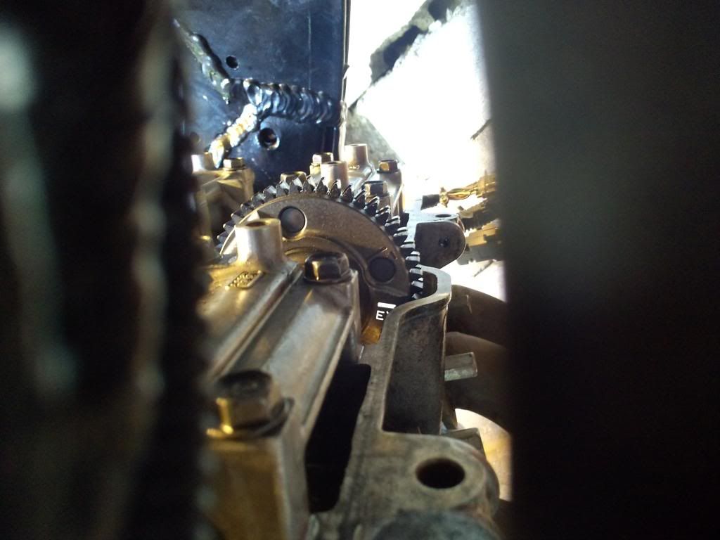

One tooth is 7.5° of camsahft rotatiom and can significant affect valve clearance. I
I have following camshaft position. Question - Am'I missing one tooth ?
IN- inlet
EX - exhaust
Here is video in HD: https://vimeo.com/69370476

Re: Camshaft position. Probably one tooth missing.
Post by tanuki » Sun Jul 07, 2013 9:41 am
that looks out to me, I found you had to hold the cam in the correct place very carefully with a screwdriver as you very slowly torque down the cam holders making sure the gears mesh properly.
