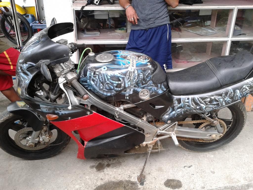

Hi guys! I'm new on this great forum and a new owner of VFR400r NC21 (My first proper project bike) It's been sitting in my friends garage for more than 5years.
It has survived a lot of typhoons as well. Typhoon Ketsana , Typhoon Parma , Typhoon Megi And alot more! (BTW I'm currently in the Philippines, But I'm from HongKong.)
Now my goal is to revive it and put it on mint fresh condition. (Or until it runs properly.)
(I've replaced the CDI and that's the only thing so far.)
I'll be posing some pictures and will be asking some questions regarding this project. Thanks 400GreyBike, and 400GreyBike members for this opportunity.
Here's a picture of my bike when I got it. (It's a mess. Submerged in flood for few days)
