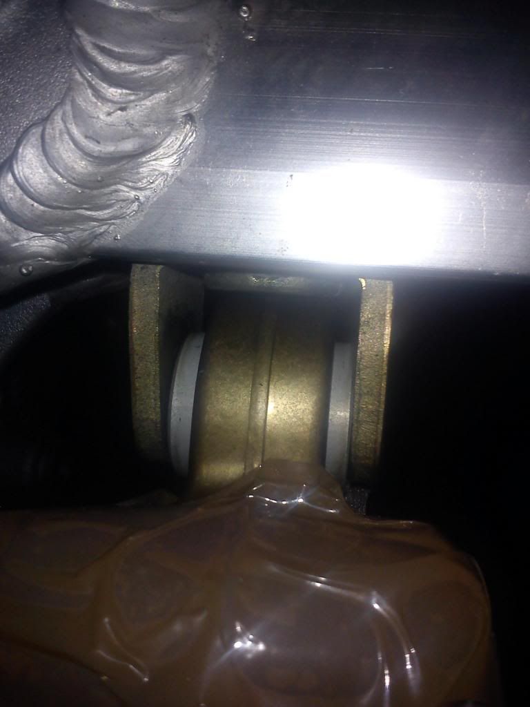

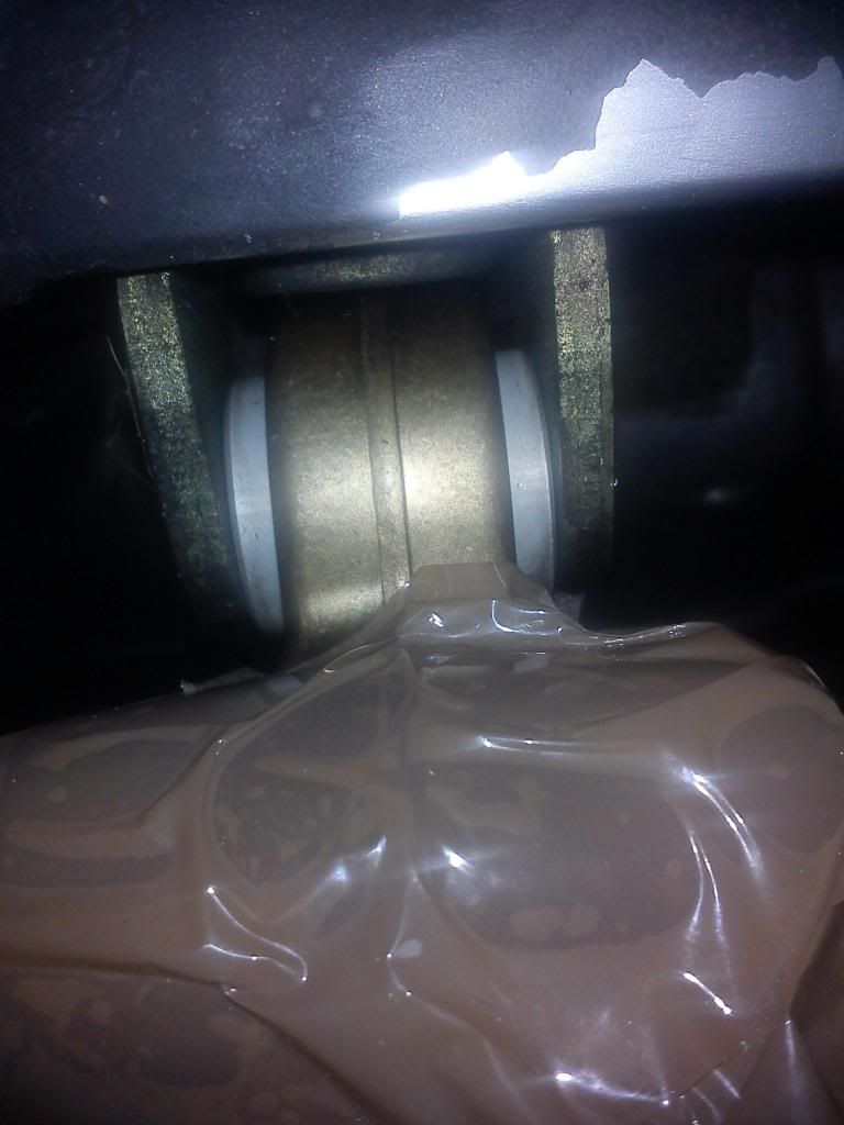

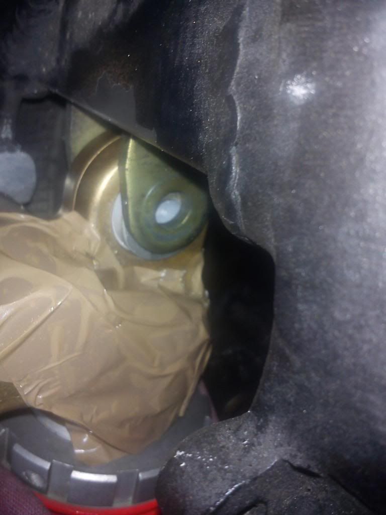

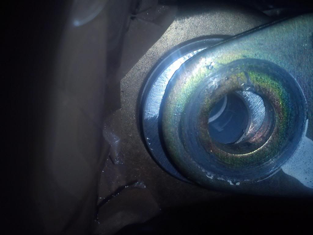

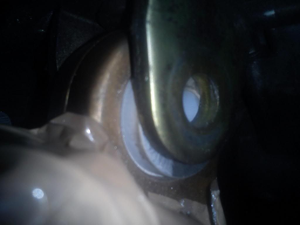

Getting my RVF taken apart for powder coaters and decided to fit the BMW shock first so I can file it away first etc before the frame is powder coated. But A slight problem is the top eye of the bmw shock wont line up as it's too tall. I know everyone I seen had done this to the VFR so I assumed the RVF would be fine. It turns out that is not the case. Pics are attached.
Anyone any ideas? I could elongate the eyes on the frame but that would raise the rear? Or would it lower it? My plan was to also fit the HRC linkage but now I'm starting to doubt this whole situation!
Anyways, any tips or ideas are appreciated!
(excuse poor photos, taken off phone, and some pics are off my spare RVF frame so it's not just a one off fault!)

Simple get a new top mount made, I had one to fit a rs250 shock a while back and wasn't expensive

I think its because your the first to try it on an RVF to my knowledge only VFR owners have tried it.
The RVF has a different top mount does it not? Other wise file some more off the top of the shock

I would remove some of the metal for the top of the shock eye,
It looks like there is plenty there,And maybe a tad of the frame.
Even if you got one made it would have to have a reduced eye diameter.

The stock mount does have a massive blob of weld on the inside which you could do without if you made a new mount so it won't necessarily increase the ride height.

The mount I had made had a countersunk bolt welded in place so it maximum clearance. Do you think the shock will bolt in if the underside of the mount was flat? I will look into getting some made as im going to need one sooner or later.
