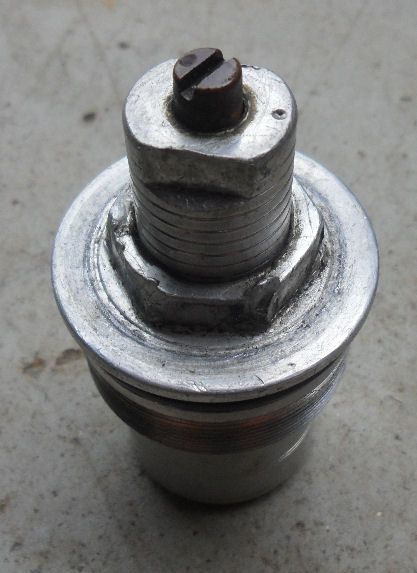

Thanks Cammo ... I have gone through this thread ... this is my top adjuster
Do I have a bitsa here ?
I have Rick O's springs & spacer in these too ... I thought I had late type forks ???

That's a late type fork top, any chance they sent you early fork tubes?

Yep Cammo ... those are in fact the beauts ... They are different for sure to my originals
The thread that you linked has me worried though as I seem to have late tops on early forks
Am I getting the correct damping ... yes I get preload... but do the early inserts work with the late tops

It's more likely that you have complete late model forks which are not compatible with the early model tubes you were sent.h2o-pro wrote:Yep Cammo ... those are in fact the beauts ... They are different for sure to my originals
Re: Can I use these fork tubes on my race bike
As cammo said.. The later tops will not work on the earleir forks as the internals are totally different.
If your fork top screws onto the cartidge and doesnt just dangle freely inside then you have the later internals too and most likely the proper fork tubes.

Hey thanks for all the info ... Here's top adjuster & insert ...are they defo the later type..?

Yes they are lter type forks.h2o-pro wrote:Hey thanks for all the info ... Here's top adjuster & insert ...are they defo the later type..?
