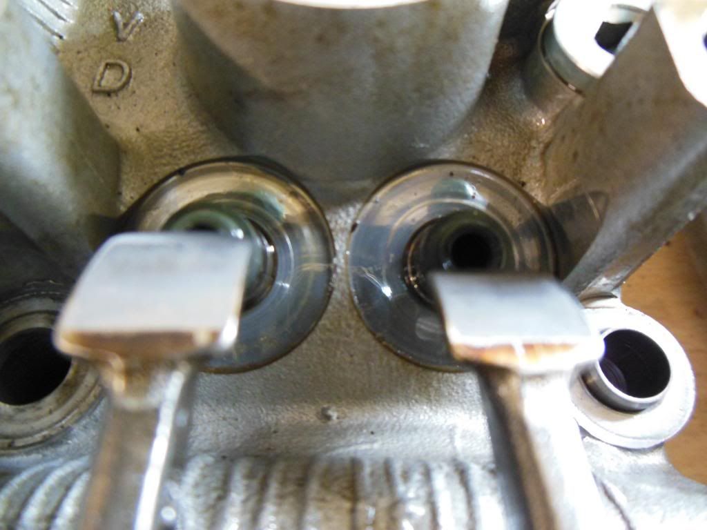

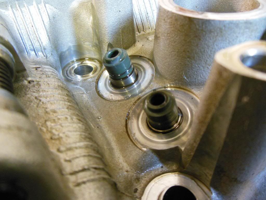

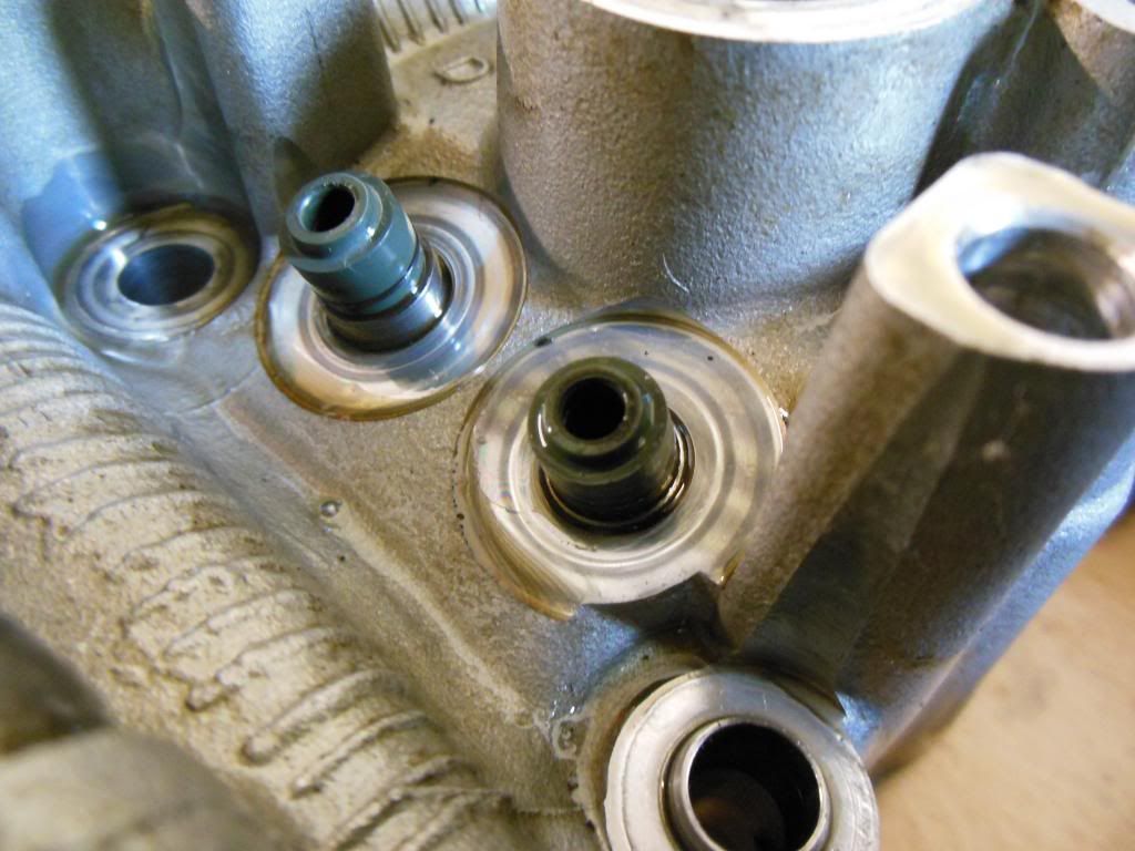

Just been removing the last 4 valves from my 30 heads and i have noticed that one of the valve guides has dropped right down, have tried pushing it with my finger and its solid, i think it must have been like this while i have been using the bike!
Here are some photo's i took:
So my questions, what could have caused this to happen? How close was i to dropping a valve and writing the engine off? And most importantly how do i go about fixing this? Had a quick look through the haynes manual and it is saying valve guide removal should be left to a honda dealership, so i guess its going to be quite costly.
Any help with this would be greatly apreciated,
Kieran.

Thanks for the replies, im not sure if the head has been worked on previously, from looking at the state of the piston tops and combustion chamber it hasnt due to all of the carbon build up on there. However there are some marks to the top of the valve guide that you cant make out in the pictures so something has come in contact with it.
The valve was undamaged same with the springs, i will take a closer look tomorow to double check, but it looks like this will be cheaper and easier just to replace the head. I will go down to my local bike garage and ask if there are any local places who could relocate the guide, but what baffling me is how it moved in the first place?!

Maybe its was just made wrong, i'm guessing its sticking out more the other end or has it just been cut down? Its a wonder the valve was shutting!

Yea its sticking out further the other end, i did try to get a photo but i couldnt get a good shot with the next one to compare it with. Scary to think what could have happened if the valve had stuck open!
