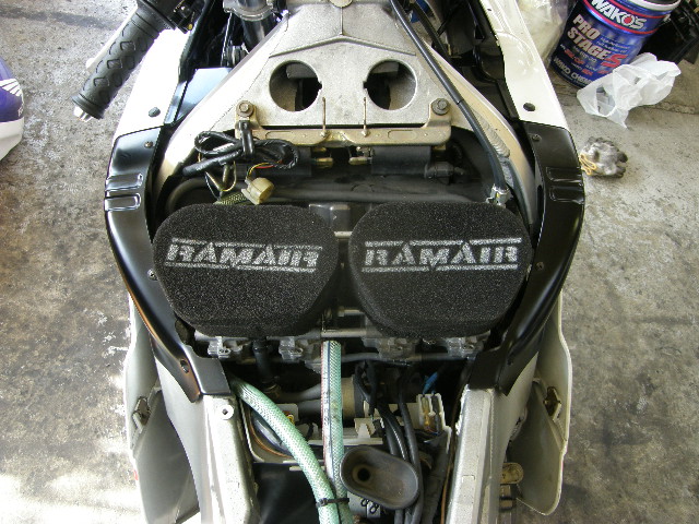

Do you mean like this?
These are for flatslides though...
