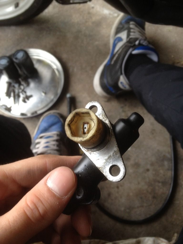

So I finally decided to get off my arse today (on my first weekend off in 6 months) and have a look at this, especially seeing as my speedo stopped working last night and I had to play "guess what 30mph is" down a mile stretch of road with 4 speed cameras on it....
I took the drive system apart and everything looked fine. The widget was intact, the cable looked fine to me, so I de-greased it all, cleaned it and re-greased it and put it back together.
Then I turned the bike on, stuck it in first with it on the abba stand and the speedo worked perfectly all the way up to 20mph (was not revving the engine more than that with no load on it).
Now I'm off out to see if it's really sorted it.

So far the speedo is working fine, seems strange though how it could play up for no apparent reason...
