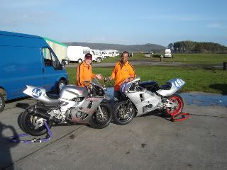

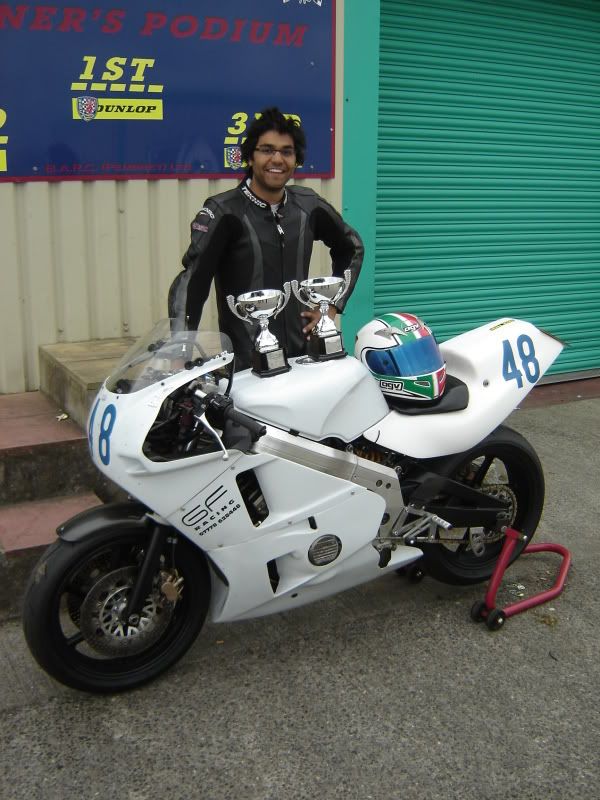

Add in Race Cams - Ported head - HRC Mapped CDI - Lightweight Wheels - Race Fuel ... Balance bottom end - RVF Pistons ... just shy of 70BHP.
In stock ...
Successful - for sure ....
Food for thought.

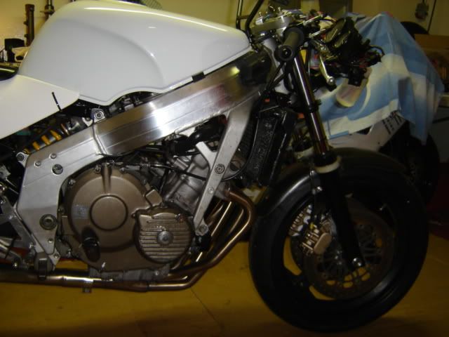

I've never had great success on the NC23 with open carb set ups.
Always found a super smooth power curve with an air box fitted / modified trumpets / jets etc .... better for short track racing.
Plus critically race headers with balance pipes make a big difference to the power delivery.
Open air box / tray for TT type race applications - yes maybe.
Team GF is not out this year due to a family bereavement and our New Restaurant Opening in Taiwan but my pair of NC23 Race Bikes are all done and ready / waiting for 2013 !!
