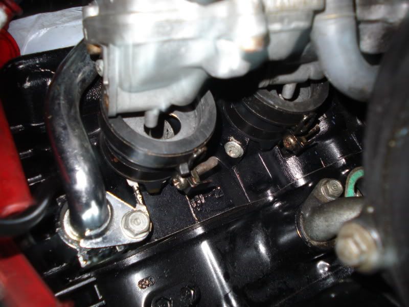

I know this answer is probably far too late for your query, but having just balanced my super four, I thought I'd post the answer up for reference.
the ports to connect the vacumn gauges to are as below:
cylinder 1 - this is simply the vacumn line that connects to the fuel tap. Just remove the vacumn line, and replace with the gauges tube.
cylinder 4 - this is exactly opposite to the above - look at the cylinder head from the right hand side of the bike, and you'll see a screw recessed between the fins of the cyclinder head. This screw covers the port.
cylinder 2 - the photo below shows this screw - it's silver, with a washer, and is very near the centre of the pic. its screwed into the lower part of the cylinder 2 inlet manifold, close to the cyliner block
cylinder 3 - like cylinder 2, but again on the opposite side. So the port is in the right side of cylinder 3's inlet manifold.
Removing these 3 screws was very tricky, so good luck. I destroyed them all in the removal process, and have replaced 2 & 3 with nice little hex bolts, which are much easier to remove. A socket won't fit onto cylinder 4, so I had to get a new machined screw.
hth
Ian
