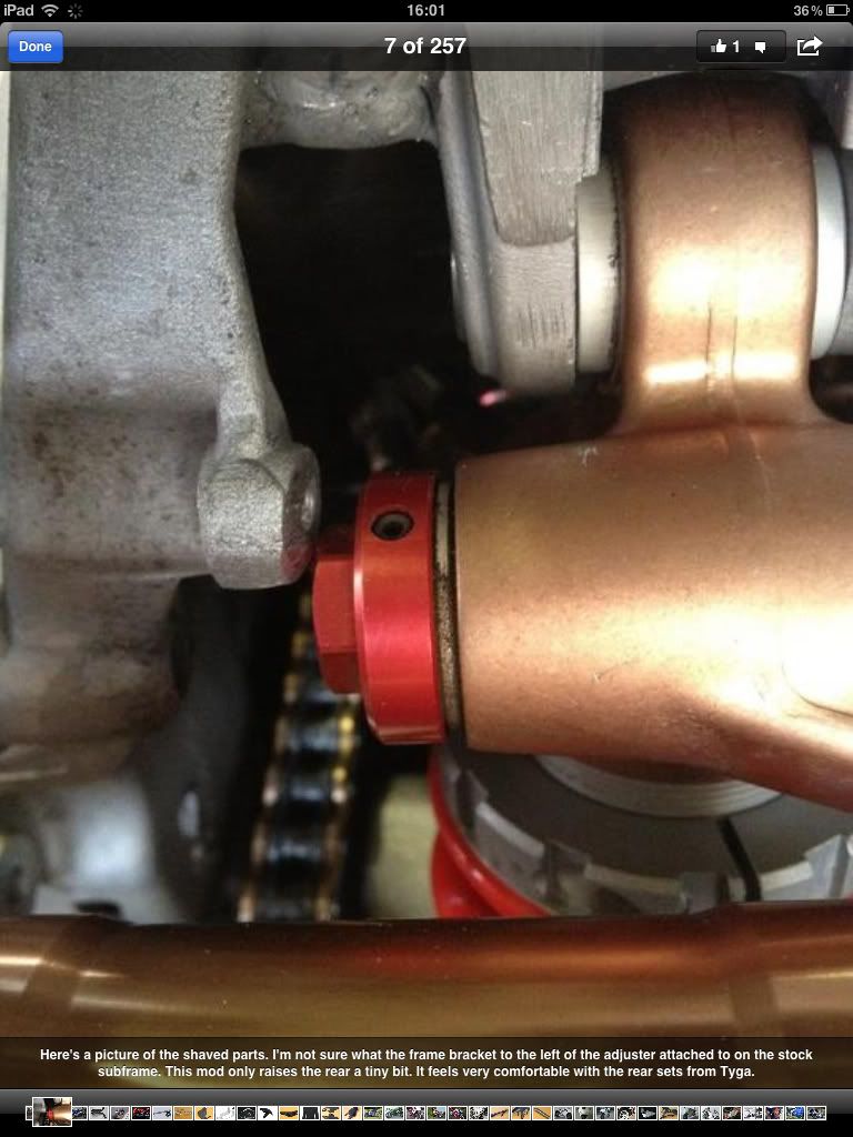

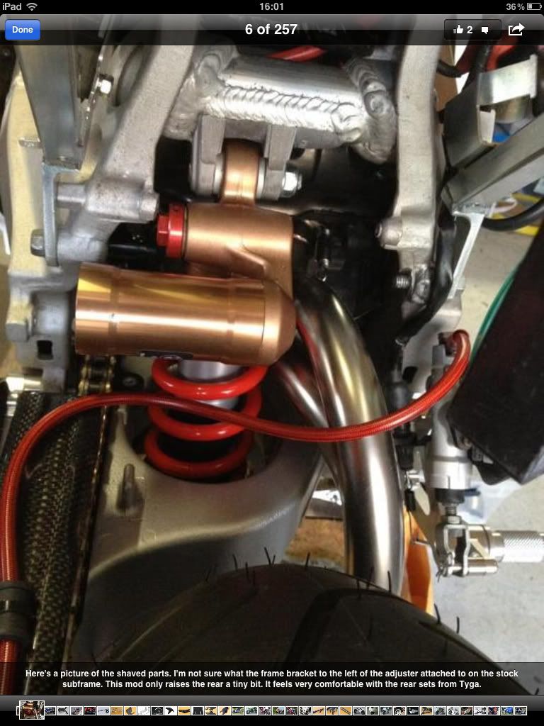

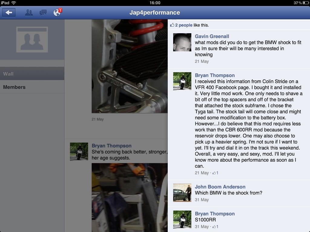

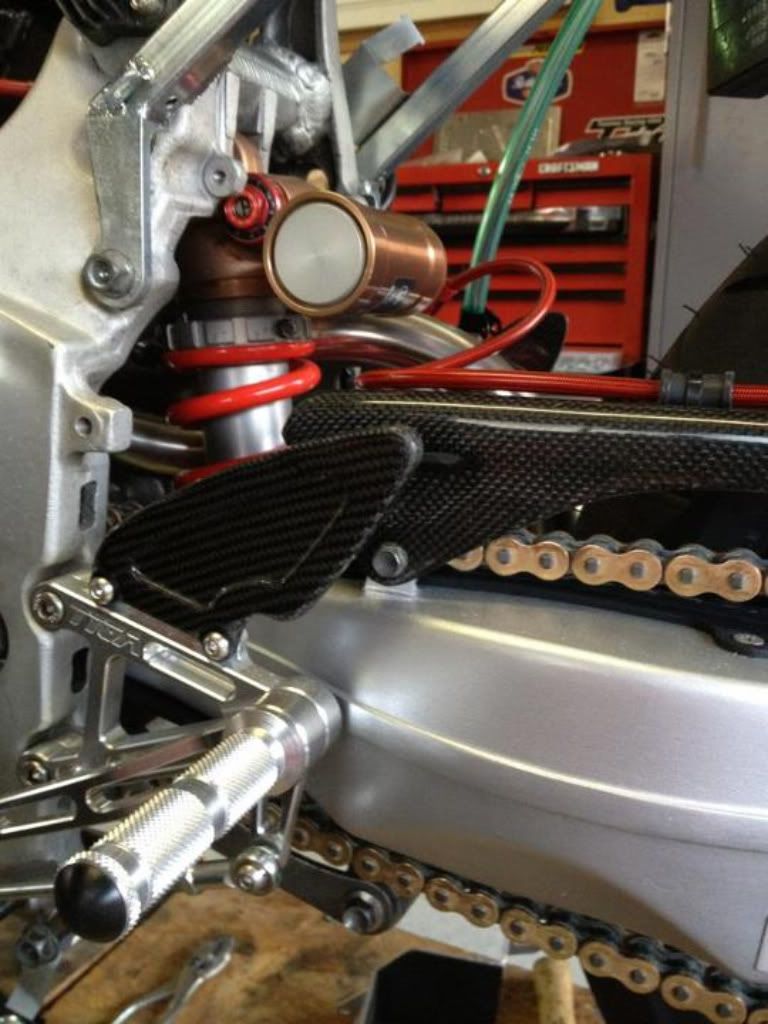

There's a pic of one done on jap4pefrormances Facebook page I believe they filed some of the frame

Here ya go mate these pics are from Facebook and there a comment from the guy saying how he got it to fit
