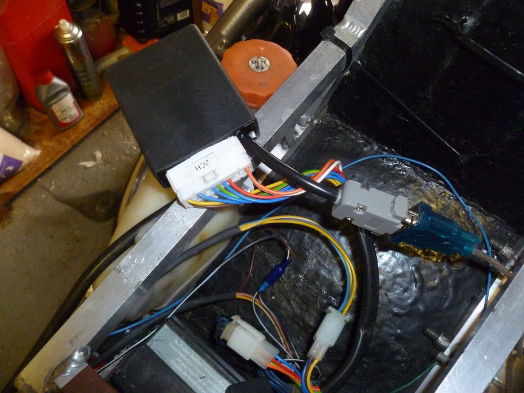

Hi guys,
Back on here again! I need some help with connecting to my Ignitech CDI unit on my NC30. I have attached a picture of it, can you confirm what model it is just so I'm starting out with the right software? I have been using software versions TCIP4 v80 and v75 and both times I get the following message when I open the prgramme with the CDI connected:
'COM OPENING ERROR'
The CDI is connected via a USB to RS232 cable and the ignition is switched on giving the correct voltage to the unit. I have tried selecting the different com ports using the software but I still get the same message. Do you have any advice?
Thanks,
Ryan.

USB -> RS232 can be touchey sometimes.
However, start with the simple, is the cable the right type? It looks like an extension cable to me..
There are two types of 9 pin cables.
A null modem and a straight wired (extension), while they have the same number of pins, they are wired differently inside.

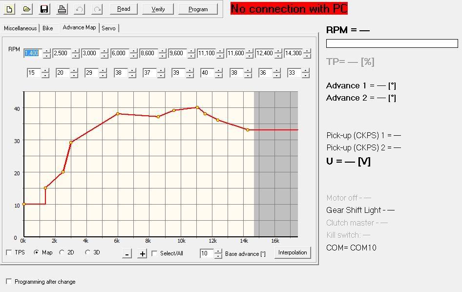

Post by brys » Thu May 17, 2012 9:36 pm
Hi guys,
Managed to get connected to my CDI now it was the cable in the end! Thought I would add a copy of the map that is on there now. Any thoughts appreciated! Going to dyno on sat and see how its running, changed my induction system back to standard with #35 pilot jets 2.25 turns out on the screws with HRC needles and 120 jets front and 122 Rear. Fingers crossed!
