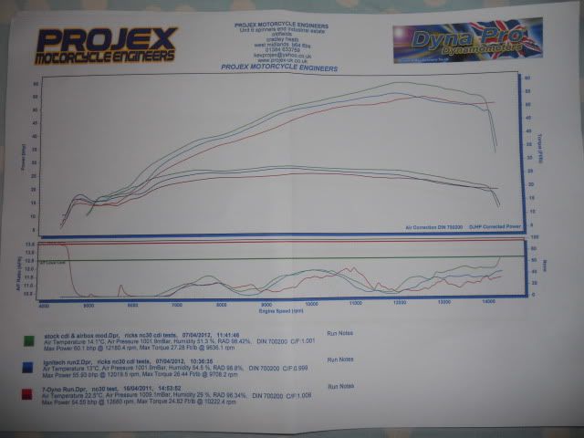

A bit of back ground with my NC30 from last year’s dyno,
We achieved about 54bhp, with Jets 120r 118f, drilled slides, 2 shims, K&N panel filter, Tyga 330mm can, Yamamota rear, standard/bandaged headers, with a flat spot in the early midrange.
In addition I had a knackered 525 chain!
We also played around with my Ignitech and couldn’t get much difference with maps back then and did try a stock CDI from Derek’s VFR, reading were about the same,
So a few changed were made, Rick O needles, NC24 slides, 1 less shim, 118r 115f on the jets and a FULL tyga system with a 440mm Carbon can and a new 520 RK chain.
I set off yesterday morning at 7.45am'ish, and gave the 30 a good cannin up the motorway and arrived in Hopwood motorway services empty on fuel! So got raped by £1.48 a litre, then headed to Kevs and arrived about 9.50am
We started with a base run of 55.93bhp - 55% humidity so up from 54.45bhp - 29% humidity, humidity was much different due to the weather being damp; last year’s test was a nice spring day.
last year vs this years first run
stock vs stock & sp unit

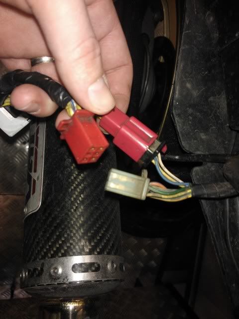

Then went onto try the NC30 HRC CDI and we hit a snag, the loom! I can only guess one of two things, either the HRC loom has different plugs or someone has chopped and changed the plugs connectors,

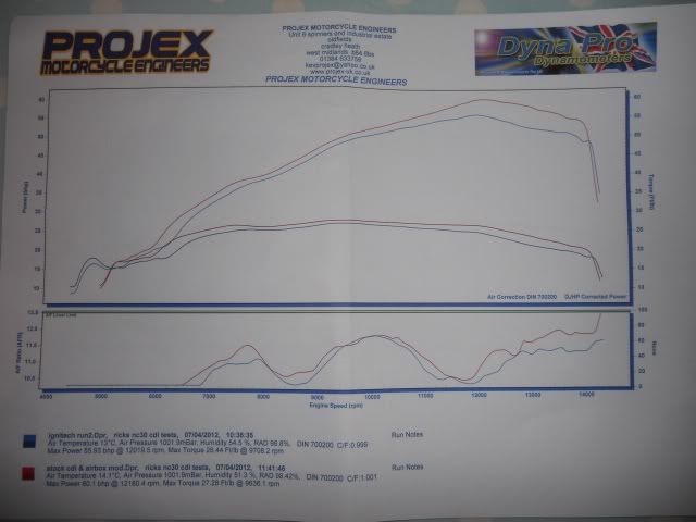

Afterwards me and Kev discussed what I could do next to solve problems, the flat spot is over rich, so either needed more air or less fuel, so said to drop the shims out, the top end power loss is down to lack of air, so we did the 400GB big NO'NO!
We removed the rubber flap, we ditched the Ignitech down on the disappointing results, and hit the dyno one more time, and achieved 60.1bhp! With just a stock CDI and rubber flapped pulled out,
Stock cdi & hrc sp unit and rubber flap removed vs ignitech and rubber flap removed
all main results green line being the last 60.1bhp
Ignitech Vs End result, Stock CDI & rubber flap removed
