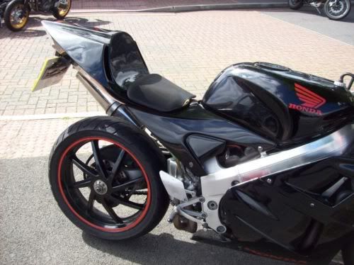

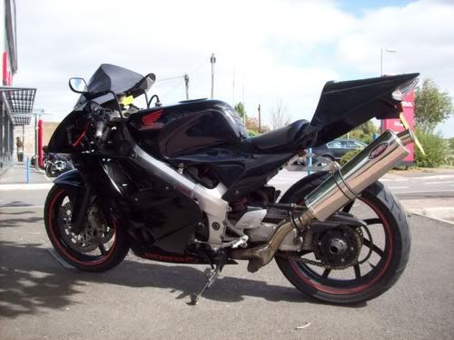

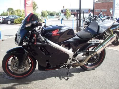

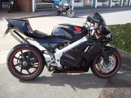

I've made a hanger out of two straps of aluminium now. Looks pretty good actually and i think it matches the overall style of the bike with the tyga kit now.
I've put the bike back together now but i do have a photo of the bike,which i'll post here, from before i changed the silencer to an NC35 one.
I thought the Tyga seat subframe sat at a steeper angle compared to the factory fitted one?
If it does then this would be why the standard hanger doesn't reach the gap anymore.
Also, the subframe on my bike doesn't look like the ones on the tyga website (unless it's a Jap version or earlier version). My subframe has a plate across the rear top surface which the reg/rec and cdi unit are fixed to.

Ok ...well the subframe you have in your picture is identical to the one on my bike.Gavin jap4 wrote:looking at the angle on your bracket it looks completly wrong to me can you send me some pics with the seat unit plastics off gavin@jap4performance.com
The exhaust hanger is at the wrong angle in my photo because it was fixed with one bolt only and swiveled to the rear so that it would attach to bodged on silencer.
Looking at the pics on the links you posted and comparing them to my pictures, i can't see why the original hanger i have doesn't reach. Maybe i have the wrong hanger on my bike.
If i come across another NC30/35 in the flesh, i'll make a point of measuring for any differences.
