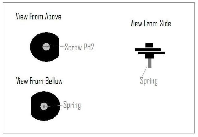

i can see what he means, but again its a trial and error and only difference noticed i guess would be picked up on a dynograph
heres one i made earlier pic to explain what he means

porndoguk wrote:i can see what he means, but again its a trial and error and only difference noticed i guess would be picked up on a dynograph

Hmmmmmmmm,
based on my crappy drawings i think youll see your answer,
one will have less flow for air
one will have more flow for air,
what you need to know is if more would increase or decrese throttle responce?

porndoguk wrote:Image
Hmmmmmmmm,
Rick

yeah i guess theoreticlly if the retainer is installed with the hole under the grooved bottom side if theres less resistance/route for the air it would give you the better responce of the two options but i would imagine the difference wouldnt be noticeable or make any difference at all.
as as Neo says if honda didnt mention it then its not worth worrying over.
