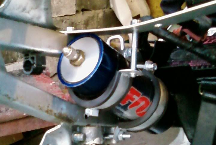

I'm going to be fitting the cbr600 rear shock at the weekend and am just after a few pointers on mounting the remote reservoir.
Where does everybody mount them ? Do I just hose clip it to the exhaust hanger ?
Any pics of one fitted would be appreciated.
Thanks

That's pretty much the standard place that people use.
