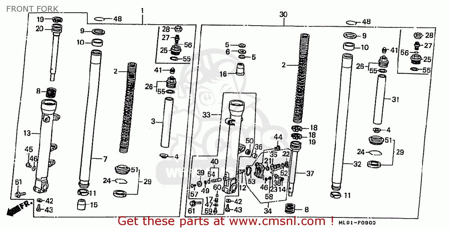

The forks are assembled like this.
http://images.cmsnl.com/img/partslists/ ... 9_0360.gif
Right Fork: 340cc
Left Fork: 345cc
Weight: 10-W
