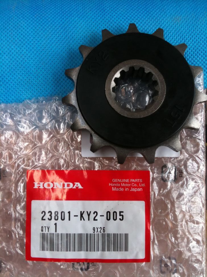

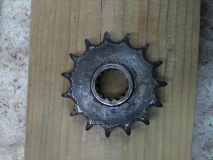

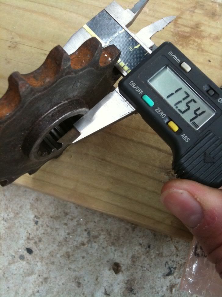

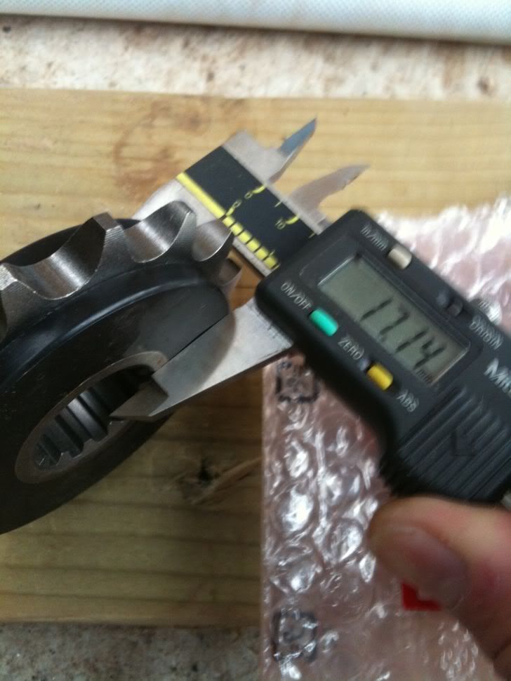

Re: NC 30 front sprocket doesn't fit
OK thanks again guys an update I called the number you gave me and he confirmed I needed Honda Part No 23801 KY2 005 and that would also be for a CBR 500... guess what thats the same one my Honda dealer specified and you see the difference is only 0.4 mm but thats allot of play on the shaft, I think I am just going to have to take 0.5mm off the end of the drive shaft but surely this isnt right and I cant be the only one?
Old sprocket off the bike
Old Sprockets thickness
New Sprocket
New Sprocket Thickness
Any more ideas? I will take a few shots of my bike just so you guys can see I am not fibbing about the NC30 bit.... Cheers again Alex
http://www.jtsprockets.com/52.0.html?&L ... uid=343&p=
You've got the wrong sprocket in your hand, no matter what the dealer tries to tell you.

Cheers amorti, You know what its like if enough people tell you an apple is orange you start believing them... I don't suppose you have a Honda part no: ? the likelihood they will give me a refund for a specially ordered part is slim so I would like to be able to give them a part number that they can exchange it for.. They reckon my bike is a K but the site details for that sprocket is L-M ? Sorry for the blurb I am just trying to get to the bottom of the misunderstanding. Thanks for the help you guys. A

The K, L or whatever matters not., The 1989 bikes are identical motors wise - I haev a 1989 and a 1992 bike and have had others come and go...the sprocket is the same beast.
What you have in your possesion is the right part number but the fiche shows that you should have a "washer 10.2mm" too - you still go tthat?
The reason the shope thinks nothing was made pre 1990 is that is what the fiche says.
So..bit of a bugger..but don't be grinding anything off the output shaft! That is madness. When a sprocket costs fuck all in the scheme of things.

Hi CMSMJ1, don't panic I would definitely not be taking 0.5mm off the shoulder of such a shaft with a grinder. Unfortunately the confusion continues. Forgive me if this seams rude but washer or not the two sprockets are different dimensions, the old one is correct and fits, the new one (second new one) is wrong and does not fit so the washer is not the issue if you see what I mean. Unfortunately I am also confident that honda aren't in the business of putting the wrong part number on the parts packet can you imagine trying to put the big end bearing shells from a CBR thou in a CD 125....( I bet dsome clever person will tell me they will fit now knowing my luck
) So I am still at a loss if w have the right number and the weong sprocket maybe they have made a boo boo? I will be purchasing a JTF sprocket (can anyone give details of a supplier?). I hope I am not boring people but I am trying to be thorough and pin point the cause of the issue so we can all learn as I do like to get to the bottom of things. I will check my engine No: as well incase the previous owner did anything odd but that is very unlikely given the engine rebuild I have done threw up no other such issues and the cracking info from amorti. Thanks again guys I will post more pics soon Cheers Alex
