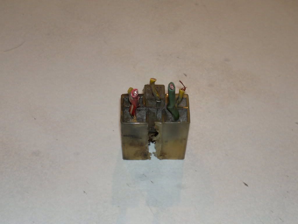

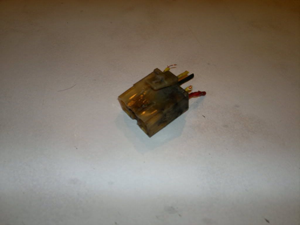

i check the battery showing now around 10 volts. so i go to the rectifier as my first port of call and find this...
so i have now removed this block fitted new connectors and re-fitted the rectifier. checked the battery showing about 11.6 volts. i have stuck her on the trickle charger and will have a look in the morning and check the voltage reading before starting her up.
question is......is the connection block / rectifier the likely cause of this problem?

the rectifiers are a common problem, my block did the same thing.
does your reg rec have cooling fin because if not then i suggest upgrading it.
or do the r6 reg rec mod.

so when you replaced the block / rectifier or both all of your problems were gone?
if thats the case then hopefully when i go out to the garage in the morning after the battery being on the trickle charger all night, having removed the block tonight and putting the spare rectifier on all will be good :pray:
i am on the look out for a r6 rectifier but short on funds at the moment, vfr mot wednesday, car mot thursday, car tax today. im pretty skint!

well its no better this morning.
checked the voltage reading before trying to start her and she read about 11.4 volts, she read 11.3 / 4 when i checked her late last night about half eleven. so im guessing it has also killed the battery. the rectifier that caused all these issues yesterday, when the iginition was turned on this morning caused the lights on the gauges to be very low and dim, the spare i have is like normal. very bright lights so the rec has definatley failed.
going now to purchase a new battery...

I cant be exactly sure what model r6 its from i think mine was from an 05, but cant be sure.
I replaced the rectifier but it didnt solve the problem as it was my actual alternator coil that was fooked.
Check out the documents library on the main page, that has a charging system check list, so hopefully you can pin point the problem.
