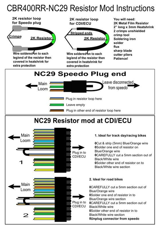

HRC looms is race loom. It doesn't have turns, headlights, sidestand, horn, brake lights and maybe starter. I don't think it's useful for road bike.
It should be something like this.

parus, thanks for sharing the diagram!

the diagram was always available, i created the diagram/hosted/posted all the links up ages (years in fact) ago.. only a few bright sparks actually SAVED the link....
in fact if you google "NC29/23/30/35 resistor mod" in the images section.. ALL of my diagrams are top of the search list!..& you will see ALL of them are linked to this site.
