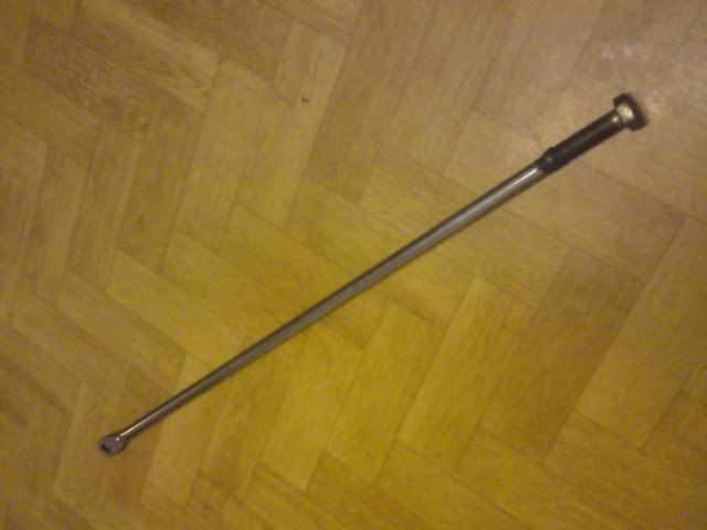

I used this to stop the inner damper rod from turning , its also useful when reassembling the forks.
Its just a 24 mm bolt (measured across the flats) welded onto a bar long enough to fit. stick on end into the vice and the bolt end into the fork and it locks the damper in place.
