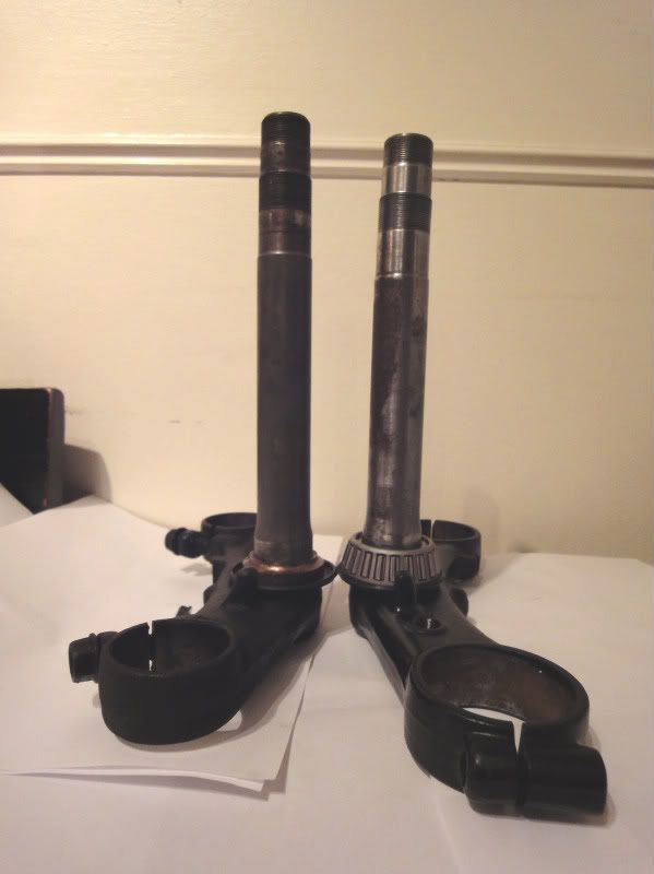

Comparison of NC29 bottom yoke and stem (left) to the NC35 (right). Notice how the 35 is slightly shorter. That's just enough to mean the locknut can't be put on when you thread it through the headstock. Arse.

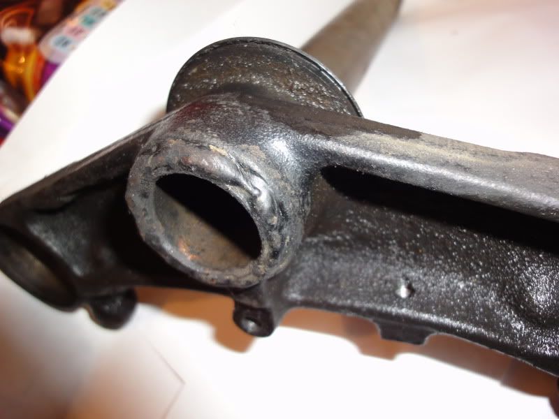

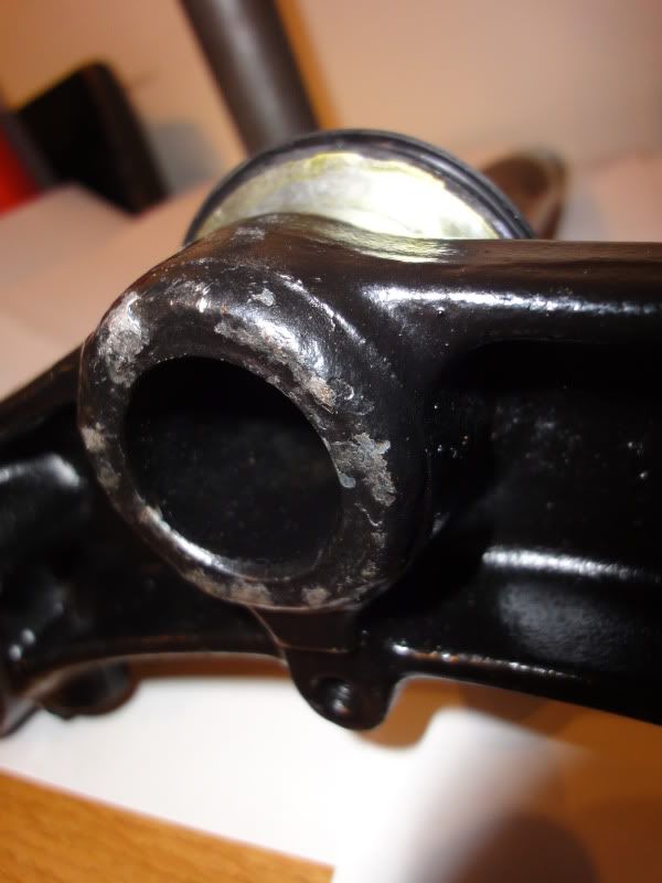

The stem is WELDED to the yoke on both the NC35 and NC 29 bottom yokes. You will need to remove this on both, press out both stems, then press in the NC29 stem into the NC35 yoke, then reweld it.
NC35 bottom yoke weld.
NC29 bottom yoke weld.

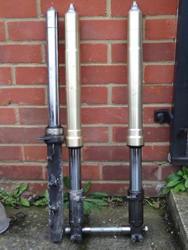

Are the fork lengths the same on the 29 as the 35?

I measured up the NC29 and NC35 stems and it turns out they are more or less identical except for the 29s centre section being 10mm longer.

Here's a side by side comparison of the fork lengths as requested
The 29s are about 10mm longer.

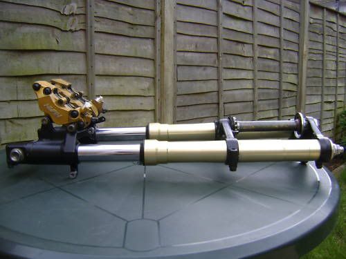

Heres a pic of mine, complete with nc29 stem pressed in and firestorm calipers. If i can measure anything for you let me know.

Nice set!
How did you get the stems swapped over?

Was already done when i bought them off ebay, not much help there lol.

Seen them before but, that IS a tasty pair of forks!
