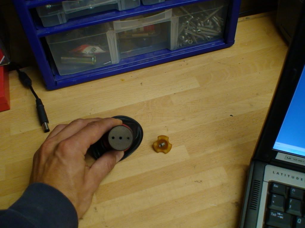

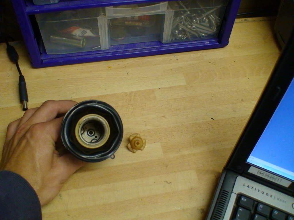

Just pulled apart a set of NC30 carbs to find these
They look nothing like any NC30 slides ive seen before and have 3 holes in the bottom instead of the standard 2. Can anyone id these please? NC24?

Ah i see, so whats the deal with the extra slide hole? im guessing theres no need to drill the slide to 2.5mm with the extra hole?

Yep.. UK 30.
There isn't any need to drill the hole bigger.
The NC24 slides have rounded bottoms and the two holes are next to each other :-)

Cheers neo, there were no needle washers either, is this another UK carb thing?

i know the emulsion tubes are different too on the uk carbs. not sure about the needles.

There fitted with standard J15A + B needles, emulsion tubes look identical to the 4 and 5 hole tubes in my Jap spec carbs.

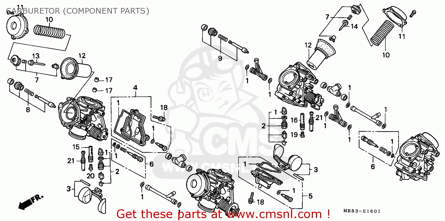

http://images.cmsnl.com/img/partslists/ ... 1_727d.gif
Are these UK carbs?
